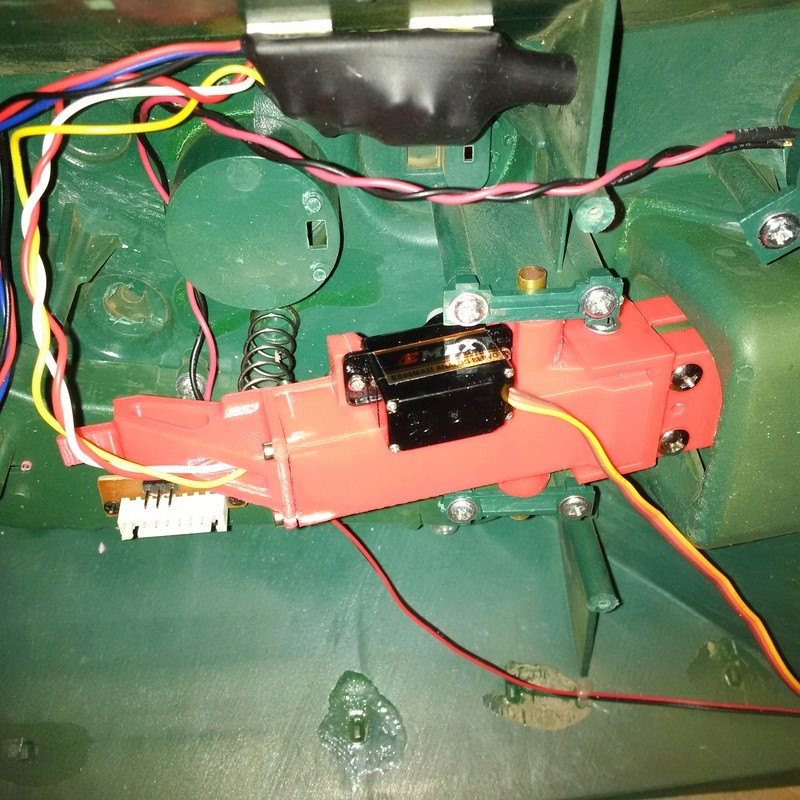

This picture seems to show a very simple setup, without the use of a MAKO board, does it work like that?

All my battling tanks use a Clark aftermarket boards, TK22 (up to TK-60). They allow for use of servos for recoil and elevation. I have an IBU that I am saving for a special project tank.PershingLover wrote:This picture seems to show a very simple setup, without the use of a MAKO board, does it work like that?
Servo recoil cannot be used by a stock HL/Taigen MFU type.
Older MAKO boards did not have servo recoil adaptability (They were purely for Tamiya IR Compatibility)
Newer ones (MAKO 2018/2019/2020/TK6.0) have servo recoil as well as some other features.
