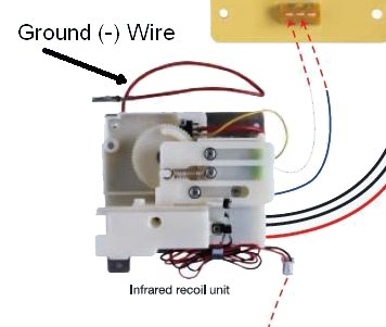

Hello everybody. Could somebody help me with IBU2 problem? After installation in Taigen tank with IR and recoil, there is no return of gun after firing (with Taigen board there is no issue). Could it be because of "ground" cable (it's going to limit switch on recoil)? Where it should be connected on IBU2 board?
Re: IBU2 + Taigen Recoil
The ground goes to the negative to the battery. If it's a 360 degree turret it should go to the blue wire in the harness. It doesn't go to the board itself. Go on the IBU website and download the manual and follow the pictures.

Yes. That was it. Thank you ;)
The stock taigen tank has the other end of this cable somewhere if I remember correctly :wave:
