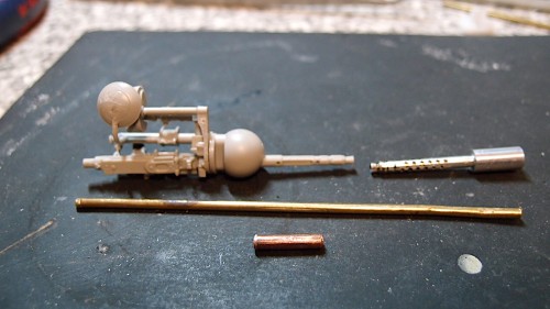

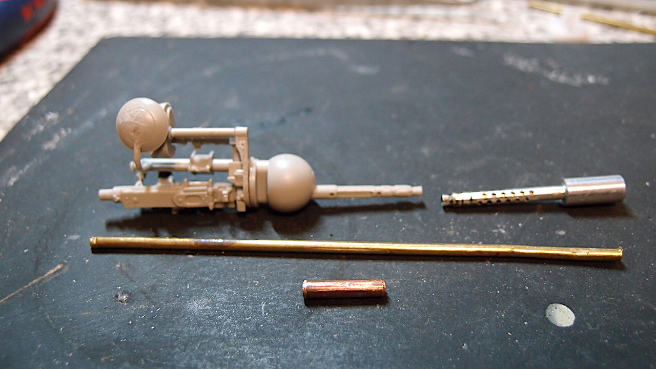

The TRUMPETER 1/16 kit is showing a few faults on my builds. If your mg has the barrel with all the holes its not correct. An easy fix and cheap.
Silver with holes wrong , Trumpeter armoured type
Easy to make with some brass or copper tubing
End result version 1, some fibre optic cable and its done. Need a think about the flared end of the mg

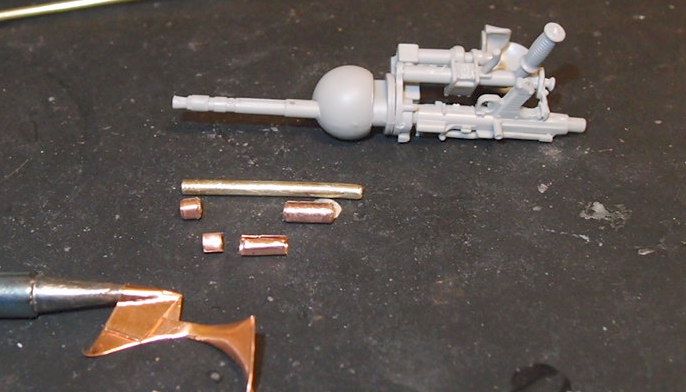

Version 2 the parts, might do away with 3rd row copper foil tubes. Soldering tip to make the copper cone at the tip of the mg. Solder next.

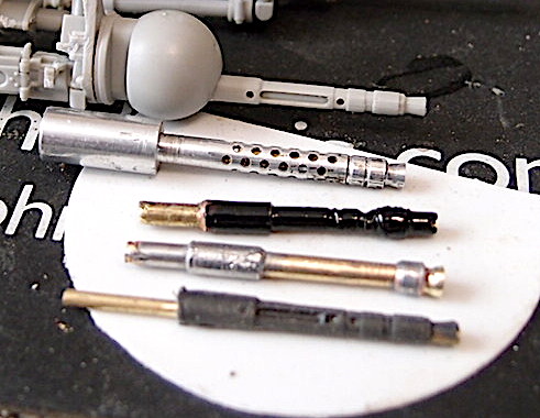

Version 2 and 3 done. A soldered one and a cast one with brass pipe for fibre optic cable.
From original mg to final versions.
