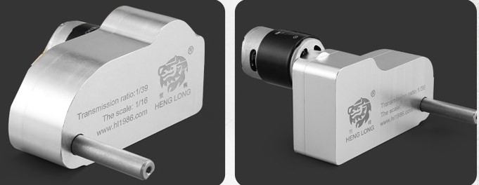

Heng Long's CNC sealed gearboxes come in 1/39 and 1/56 ratios with both short and long shafts.
