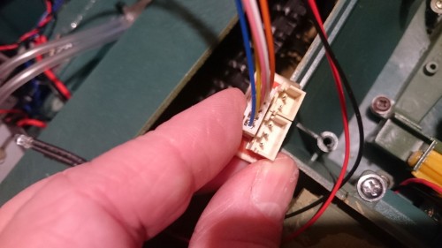

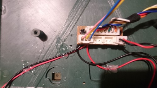

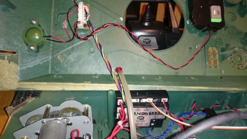

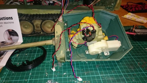

i have bought a 360 bb taigen slip ring set .for my panther g .
when i opened her up i seem to have a problem with the amount of wires comming from the turret .
on the taigen plug provided there is a 4/3/2 plug see pics .
but coming from my turret there are 3- 2 pin connectors .
i have plugged in the 4 pin but it then leaves me with the 3 2 pins to plug in
1 from the rx unit replaced by tagen kit one
1 for turret control l/r
and other one for elevation .
i have tried this on an older panzer 3 and it had the 3 and 2 wires in the turret only ?so it works .
but the panther g has the newer barrel elavation mech hence extra wires .
i can plug in the turret so it turns but thats it no elevation .
can any please tell me how i can wire this in so it all works as im a bit stumped .

Perhaps the HL slip ring would be a better fit than Taigen:
https://www.hayaltd.co.uk/Heng_Long_Tai ... 59161.aspx

you sir are a star .
very much appreciated as the taigen one is frying my brain .
thanks again
alan
