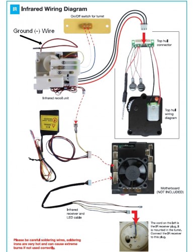

Hey guys, thanks for all your responses. It RCtank.de in Germany. They had sent me a revised Asiatam 'Refit' B rewire diagram..
So,
Painting, weathering, camo, airbrushing w/ my trusty Badger, static models, done loads of Star ships, with blinking nav lights, spots etc, RC planes ...but this Asiatam unit is beating me up.
First off, I re-wired the unit as per RC tank RCtanks Mr Slembrouck ? ..then the yellow lead of the recoil side micro switch sheathing started to smoke and melt.
Then today I discovered why, the large gear on top, was installed upside down. The pin the strikes the microswitch tail was facing up. the raised molded in portion of the gear..looks like a 'C" was facing down..everything jammed up. Fixed that...
Now though when I plug everything in, both motors just run ....the elevation gears spin, the recoil functions, the flash goes off and tracks recoil perfectly. Except my transmitter doesn't do anything. I plug it in, meaning when I plug the recoil leads into #2 position, and elevation motor leads into #4 position of the hull daughterboard . turn it on at the on/off switch on the hull bottom, it just runs and won't stop.
I'm close now that I found the upside down gear install...but far away !
Any ideas. I can load a few pics if anyone has a suggestion or 2.
JEFF

Re: DePanzer revised tutorial for HL recoil/flash kit
When I get home I'll get the lid off and check the wiring Jeff. I'll take a load of pics for you, as I've got the same in the Jagdpanther....
That would be super If I could see a few pics from your Jagd
!! RCtank, Germany sent me a revised 'Refit B' wiring diagram, but each side both elevation and recoil run continuously. The transmitter has zero control over he board.
It is darn frustrating because the recoil, flash, track recoil are all in sync...and it's super cool. See if I can load up a few pics of what I have going w/ the wiring
