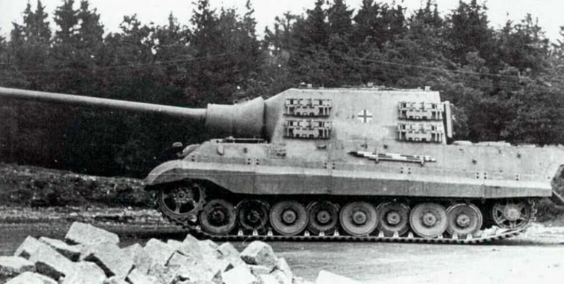

Which brand is the lower hull?
On the models I've seen so far, there's a "huge" gap between the idler wheel and the road wheel in front of it.
Your model looks more like the real Jagdtiger, with no gap.
Very nice altered model btw, looks awesome!

i will support Rob with a drawing:

Really nice JT.
The Henschel lowered versions have a gap between the idler & last road wheel that is quite pronounced in some pictures.
The right side is less obvious and even less so depending on the deflection of the wheel at the time the pic is taken.
My model has a similar trait.
The gap of course is also influenced by the position of the idler when used to tension the track.
I have mine on the rearmost setting(track tight) but have left an extra link in the track to get the right look and performance.
Once the tracks wear I should be able to remove a link and set the idler closer to the road wheel .

Yes indeed.
In most 1-16 tanks that gap is very visible, and on real tanks it doesn´t look like that at all.
