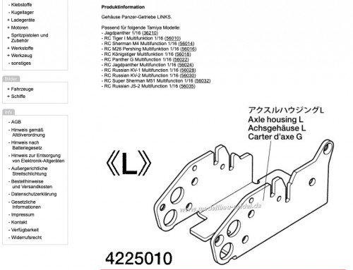

One example, below, is the Tamiya Gearbox housing. I discovered that it is actually identical for most of the major models, with the exception of the Panzer IV. This means that any box can be adapted to fit other models in the list below, so long as the correct driveshaft are fitted, and the correct standoffs used. In some instances, (given that the shaft is only held in by a circlip, and can be removed in seconds) anyone with a bit of milling skill could even adapt a driveshaft to fit another model.
Here's the housing: Click on the pic to ENLARGE it...
