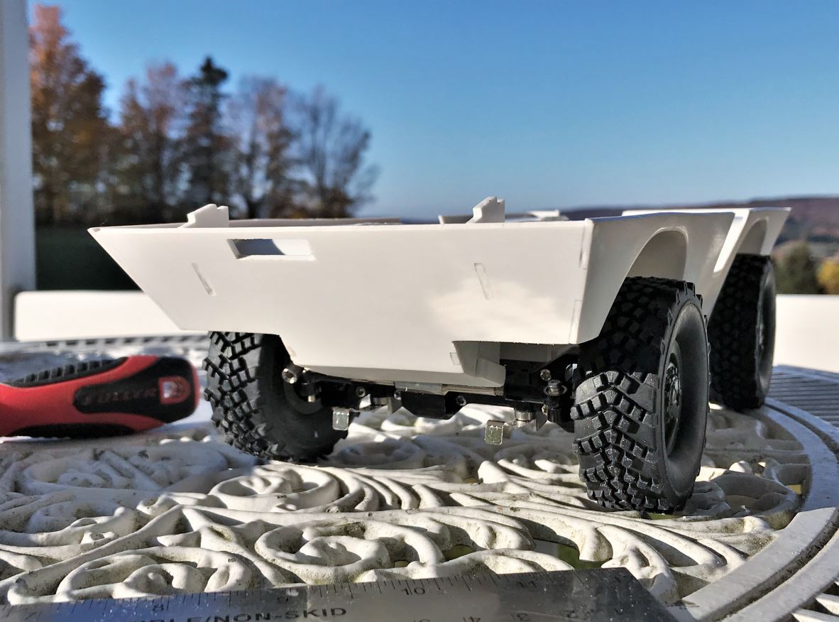

As mentioned in earlier post, this will be a much different integration of the running gear with the Ludwig hull than what was done with the V100 Commando build.
The lower hull is constructed as per instructions, a task that takes a nice Canadian autumn whole afternoon. Everything needs to be strait and solid.
The shaft of the gearbox is too long and need to be cut, with the groove recreated with a file. It only takes a few minutes.
Shown here is my installation of the 370/Motor/Gearbox within the lower hull.
Notice the stronger drive shaft that gives me better confidence than the earlier version shown in the previous post. Take note that I have not done test drives at this time so I do not know if this runs well or not yet.
View from under the hull. The heavy metal axles were installed using the regular WPL leaf spring suspension. But I ordered additional springs in order to reinforce these simple ones. The axles mountings are a bit larger than the bottom of the humm so I had to add a plasticard strip under the leaf spring screw in order to fix it solidly.
Notice that the tip of the leaf spring has not been anchored. I am awaiting the stronger leaf spring (on order) before finalizing the axle installation.
Be aware that the installation of the axles requires a bit of planning. They need to be centered and also at the right height. With this first step completed, the engine tests can start before going further.
