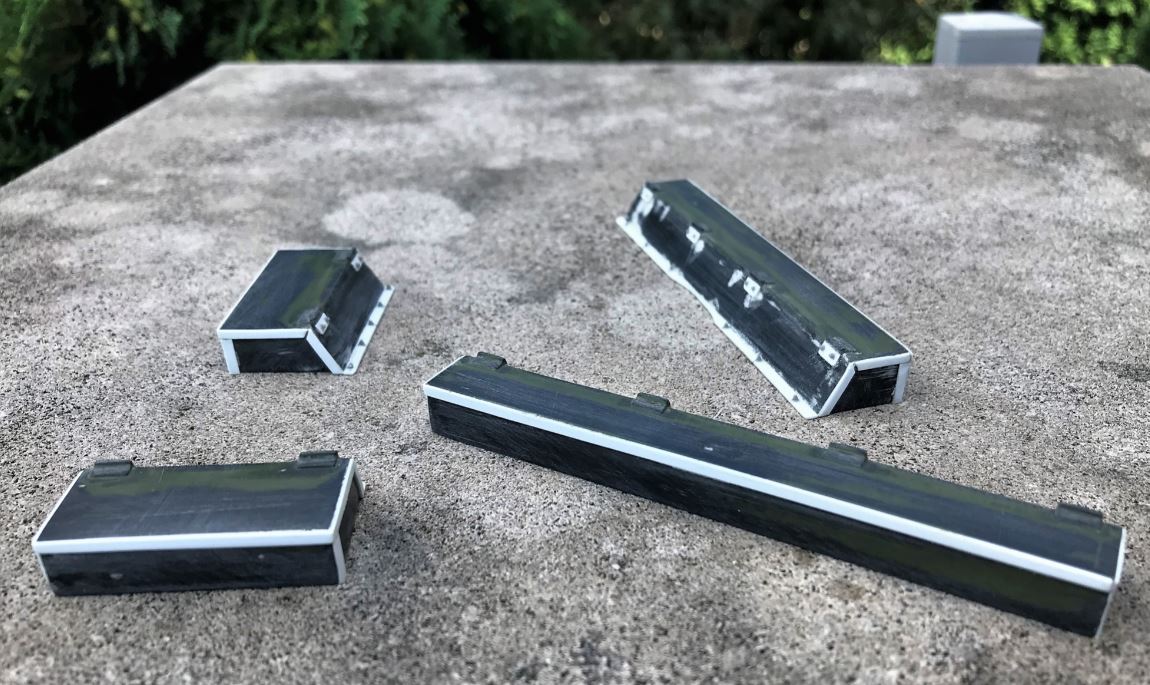

Notice incorrect back slope of the original on the right side and reworked model on the left. It just need sanding with the Dremel. The original bins are also much lacking in details.
1/18 RC M-48A3 Patton build
The detailing is done and the bins are ready to be installed on the fenders. It somehow took a long time. The Schumo M-26 handles will be added when i receive them from Axel Modellbau.

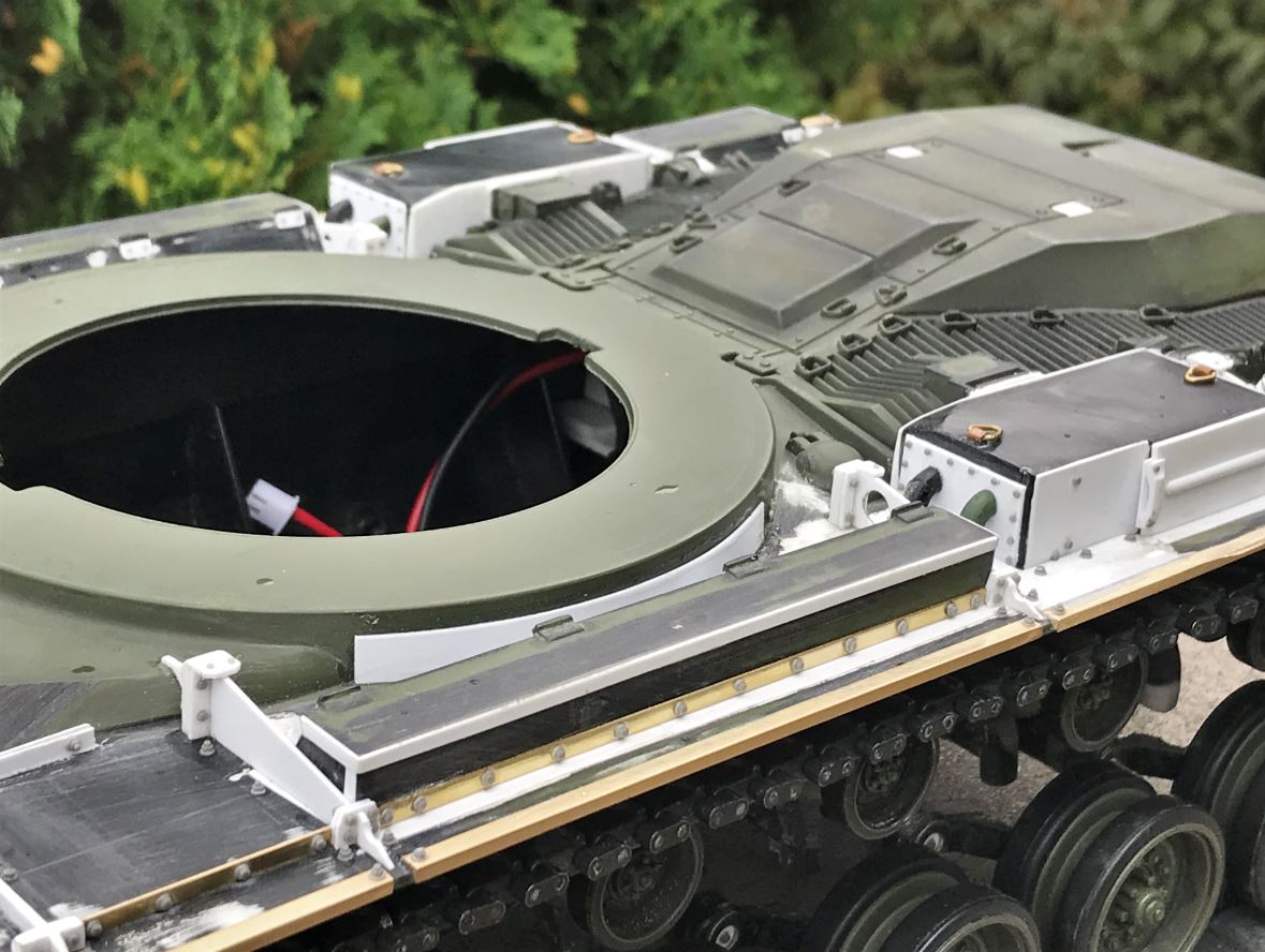

The bins are positioned and the fine detailing of the fenders with all the brackets and supports braces can now be started.

I started the fenders support brackets. Much more to come on these.

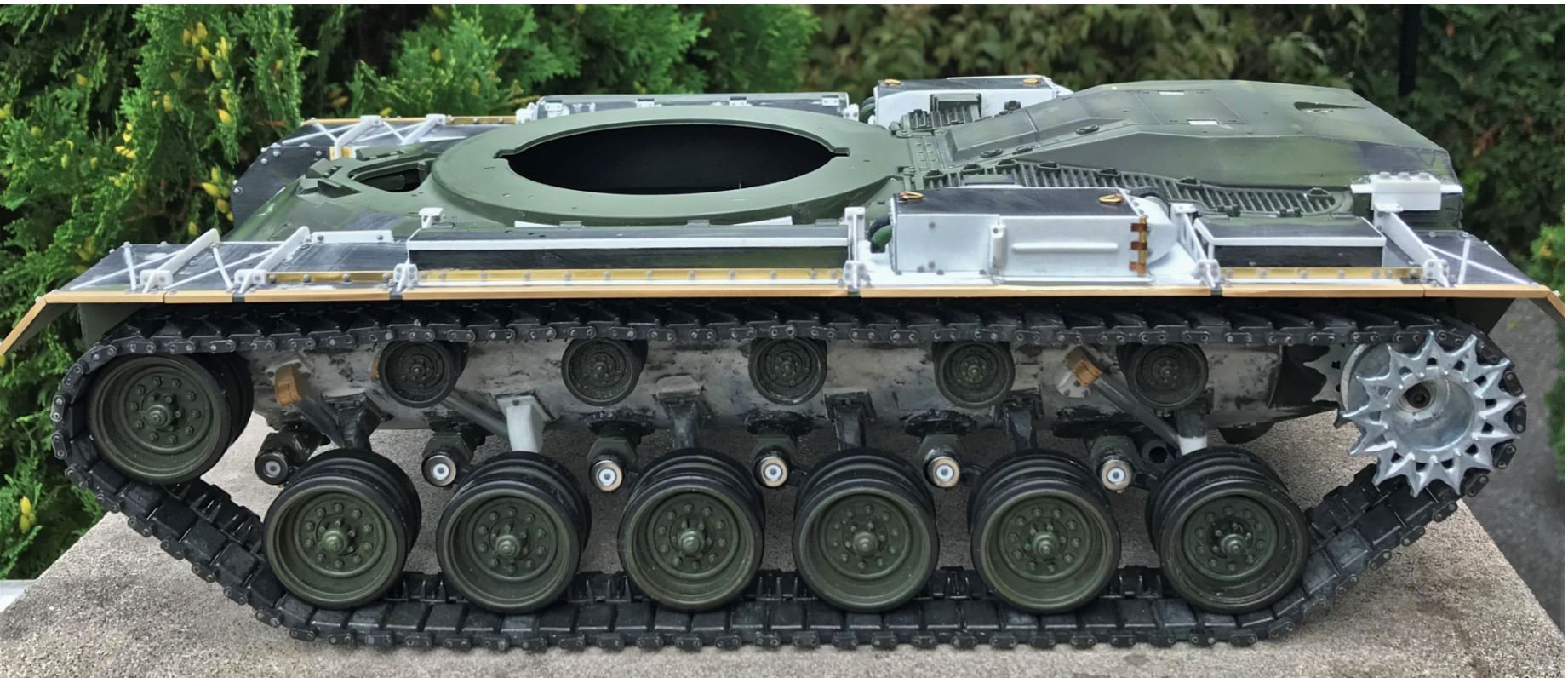

Also installed the newly received 1/16 Mato M-26 metal tracks and sprockets as replacement for the plastic ones i had in store. They are really superb tracks and they give the model tank the weight needed to properly activate the suspension instead of flying over obstacles. The tracks and sprockets are on sale at Mato Mart for $67 US, highly recommended. It would have been nice to have the right M-48 tracks with rubber chevrons but the M-26 are the closest tracks available.
They are correctly articulated. Each link is made of 7 parts. I am really glad these come assembled because just removing one link to make them fit the M-48 gave me a small struggle but it went faster with the second track. They might have to be soaked in oil for proper running, tbd later.

The M48 fenders are rich in brackets, braces, bolts and nuts. These are worth reproducing for a detailed model. The M48A3 Mod B version had re-enforced fenders and the attachments are different than the early M48A3. As the tanks were modified to Mod B, remnants of the early brackets can still be found on the front glacis. There are also variations for the Mod 3, the embossed stiffeners are sometimes not there on the 3th panel from the front.

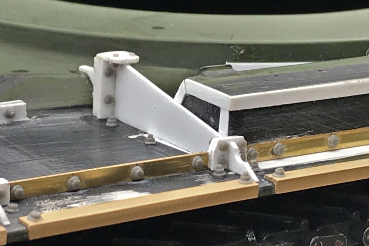

I have spent 20 hours to rebuild the fenders that I had previously totally flattened. A key item to add is the L shaped 2mm x 3mm brass strip alongside the exterior of the fender in sections, in addition to the brackets and about 120 nuts and bolts on each side. Installing these Meng nuts and bolts is enough to make you sick but they are really important for the accuracy and look.

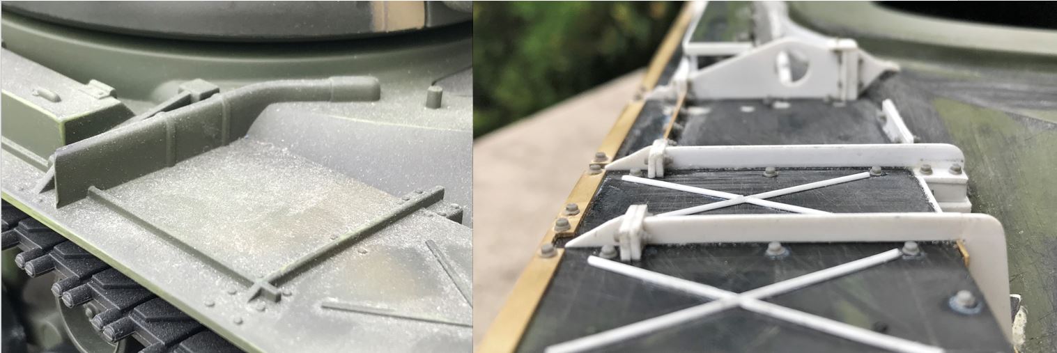

Following at 3 pictures that compare Before (left) and After (right). The 21st Century model is an early M48A3 so there are differences in layout but you can see where the changes on common components.

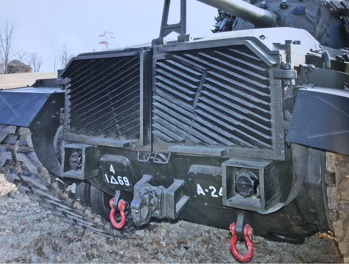

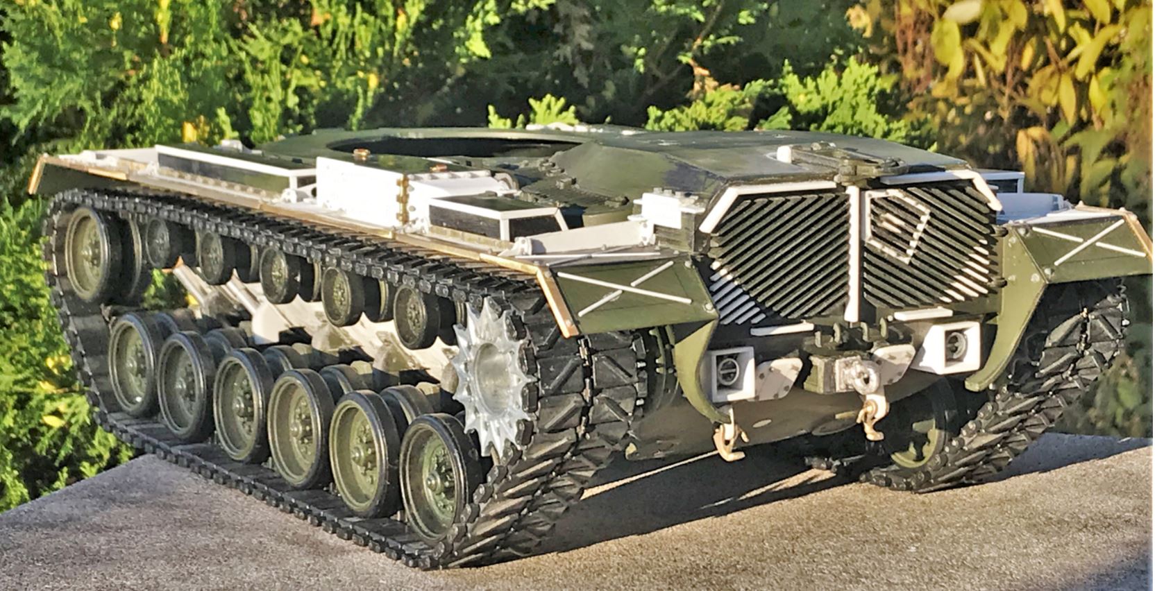

Presenting the rear of the tank
The rear of the M48A3 Mod B has differences with the early A3. Notice the heavy armor strips placed around the grills and the squared armored box around the tail lights. Analysis is required to determine all the improvements that can be made.

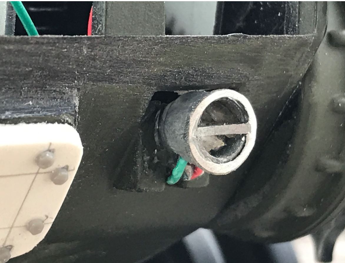

I decided to install Mato Sherman tail lights on the model. I did not reuse the 21st tail lights as they seemed under scaled. As this 1/18 M48 is as big as an 1/16 M26, so use of 1/16 small items do not really look out of scale. After removing some of the metal bracket on the back of the Mato lights, the mount on the model almost seems to have been designed for them.
Here is the almost finished M48 rear. The armor strips on the grills and armored boxes around the tail light were added, and some additional details in white plasticard. AFV_Model M-26 shackles were used. One area I did not improve yet are the grill doors and hinges details on the sides. TBD later because there is some structural issue with the side of the grills that need some thinking. At this time, I prefer to move on to the turret.
