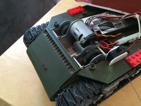

Just have a look at what you like & buy that. Then buy another one..... The lack of space in a P3 is easily fixed by removing the battery tray, that & magnets (or Lego) to hold the upper hull on with longer wires are an easy & useful mod.

Yes, got that one off Frank. I use magnets: 2.5mm fit nicely inside the upper hull screw holes & 5mm up the lower hull posts. Exact sizes may vary....

Lego! It's a new one on me and gives me some new ideas for mounting my SU-100 shell on the t34 hull - thanks!
