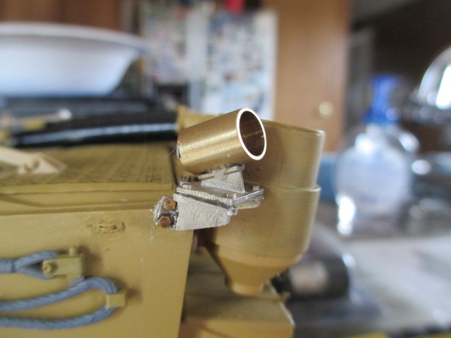

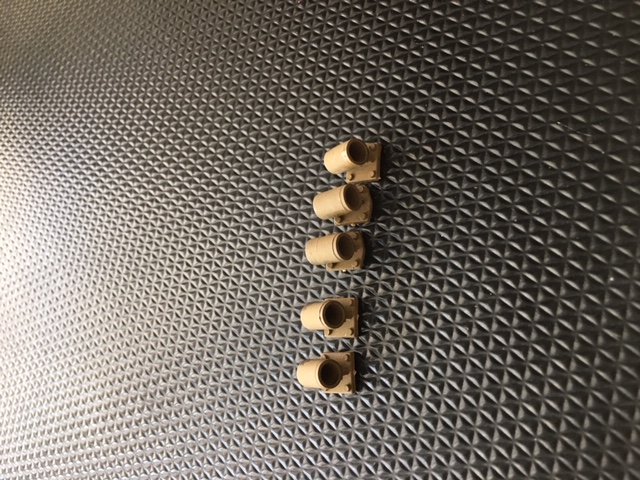

Received these with my Taigen Tiger 1 mid....Is my assumption correct?

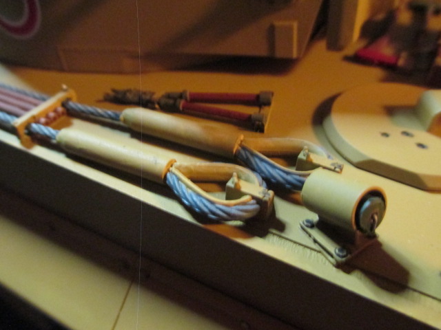

Smoke screen bomb canisters\candles were found on specialized mounts on the turret and generally only on early Tigers. What you have there is the anti infantry canister thrower, ( 'S' mine ) another thing found mounted on early Tigers ( on the deck ) . They were supplanted by a turret mounted launcher under an armored cover on some middle but mostly late Tigers

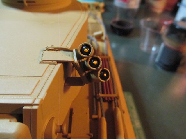

- Smoke Candles
- Homemade Smoke Candles.JPG (91.04 KiB) Viewed 1435 times
- 'S' mine closeup
- 'S' Mine Closeup.JPG (93.52 KiB) Viewed 1435 times

I want to add the smoke candles to my turret mounted launchers. Any link showing how to scratch build these?

The ones pictured were very simple, 4mm shot in black with a tip of yellow paint. Get yourself the Aber set or the Voyager set for the launchers that have the wire and chains, etc in brass. Really adds some detail to those mounts.

Smoke Canisters were first fitted to the Tiger 1 in August 1942, New Build Tiger 1s ceased having them installed after June 1943,
They were usually Turret mounted in two groups of three with one group on each side of the Turret,
The Tanks already fitted with them often retained them which is why some Tiger 1s were pictured after June 1943 with them still installed.
The Top picture shows S-Minen Projectors which were fitted from January 1943 until October 1943,
There would usually be one projector on each of the four corners of the Tiger 1.

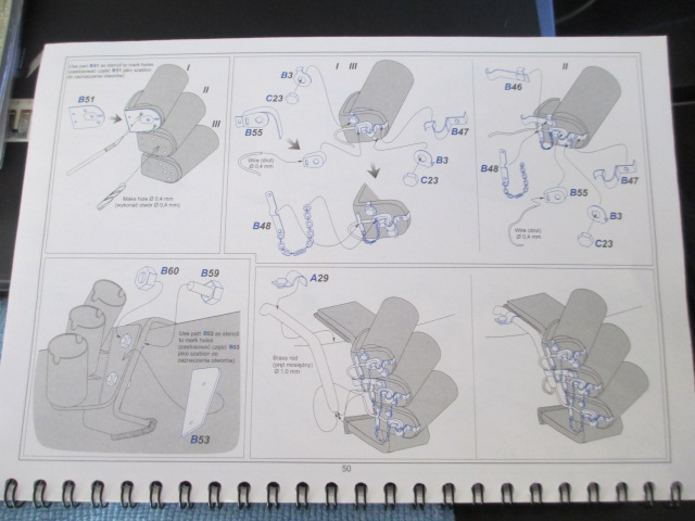

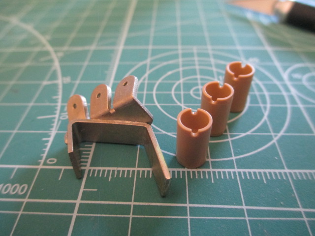

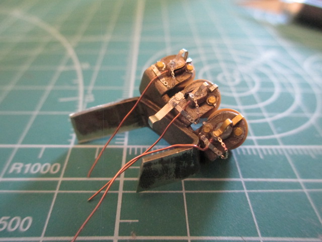

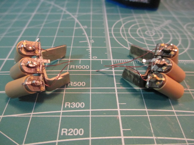

A couple of the build pics for the ABER set just for you and the OP's enjoyment.
- Mount taken apart then drilled and pinned back together
- Mount taken apart then drilled and pinned back together.JPG (84.87 KiB) Viewed 1318 times
- and add the ABER bits to get this
- and add the ABER bits to get this.JPG (97.64 KiB) Viewed 1318 times
- Start with these Tamiya and Wecohe parts...
- Start with these Tamiya and Wecohe parts....JPG (98.08 KiB) Viewed 1318 times
- ABER Instructions
- ABER instructions for the turret smoke launchers.JPG (95.82 KiB) Viewed 1318 times
