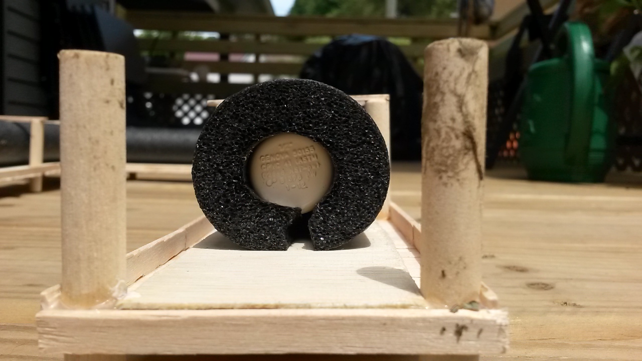

As it has hidden flotation devices, I think we now need to see it upside down, and I don't mean a rotated picture

Thanks, guys. For a quick knock out, I think it really came out pretty good. Still have to stain and seal it, then add some details.
Here ya go Mick. Upside down!
Here's a shot showing how it's assembled.
The inner frame is 1/2 PVC pipe covered with pipe insulating foam. The dock planks were glued down to a thin piece of plywood. I let a few planks off until I mounted them to the pipe pieces. #6 counter sunk screws fit great in the openings. After the decks were screwed down, I glued in the planks covering the screw heads.
I took a tee fitting and reamed it a bit until it fit all the way over the pipe. I did this to make a hinge for the ramp so that it could be adjusted depending on the conditions where I was running the boat.
And a final shot of the complete dock from the top.
