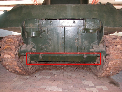

Found something interesting on this site page.
M4 Shermans Composites (Hybrid) with small and large hatches
http://the.shadock.free.fr/sherman_minu ... osite.html
"Trailer towing pintles were standard on the Sherman series by the time Chrysler began M4 production, but they don't appear to have been factory installed on any of their Composites. Chrysler was directed to install the pintels on M4A4s starting in April 1943, but it was found that they bent up, making it impossible to open the engine access doors. Consequently, "It was immediately burnt off as many new tanks M4A4 as possible," and further installation was suspended. At the change over to M4 production, it is likely that Chrysler had trouble finding a supplier for the pintels, so that the Government gave them a temporary "pass." In any case, in period photos showing only the rear, an M4 without a towing pintle is likely to be a Chrysler built Composite. Right side photo of M4 at RAAC Museum, Puckapunyal, Australia, courtesy of Leife Hulbert."

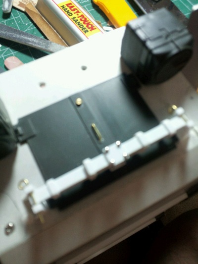

This is mine from my Firefly build.
- Rear Tow Bar Mounted not completed.jpg (53.1 KiB) Viewed 1810 times
