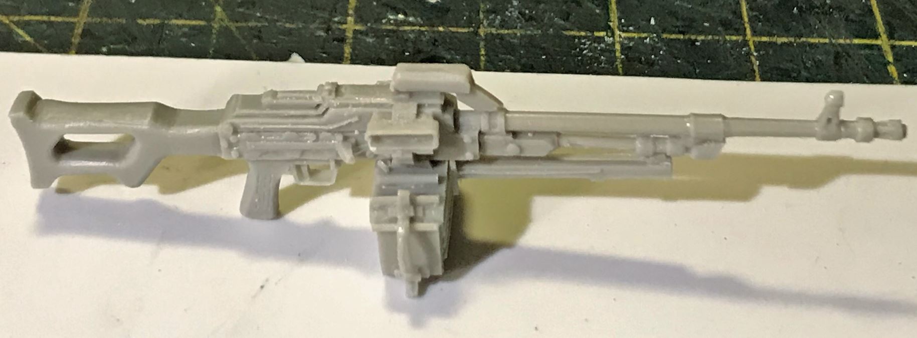

One figure is armed with the Reedees Miniature PKM machine gun.
Reedees PKM
Reedees PKM

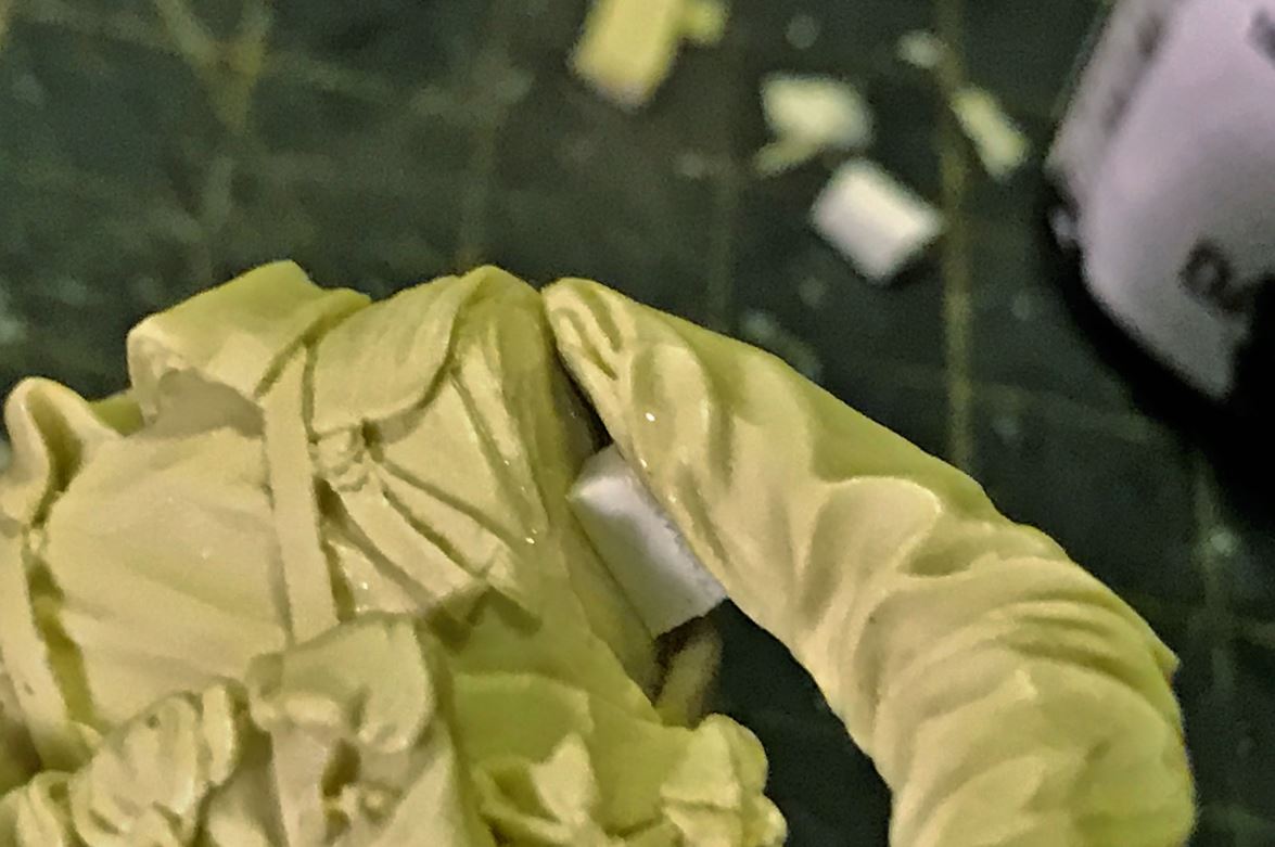

The buildup is starting. Need to first have a vision as to the overall positioning of the figures. Each pose is made unique, a small project by itself, and quite fun. It is important to dry fit many times everything, make adjustments, with the available space on the BMP, general layout and the weapons as tri-dimensional base to position the legs, torso and arms. Putting resin parts one to two minutes in the microwave allows for nice reshaping of parts, such as for adjusting the angle of bending on the legs, and for the fit of the lower part of the flak vest against the legs.

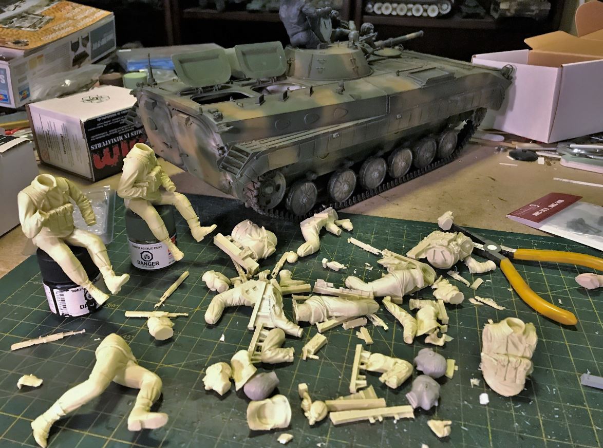

The lower body is assembled as required for the pose, and made solid with plasticard reinforcements.
BMP-1 infantry
BMP-1 infantry
Then the body is recarved, reshaped and the joints are redone.

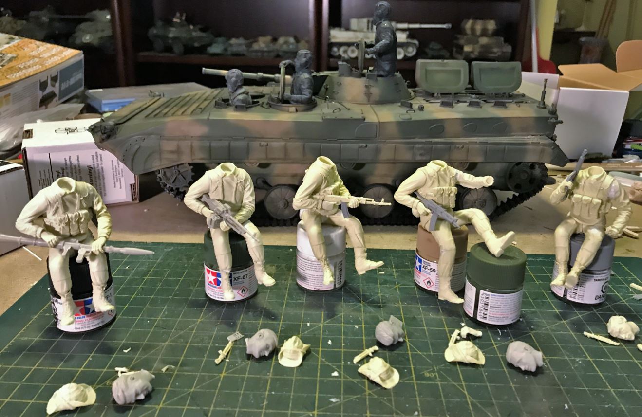

Here are the 5 Soviet 1980s infantry figures ready for painting. The heads, hats, weapons and most hands will be painted separately and assembled later.
Overview of the figures, all coming from the same Kirin kit

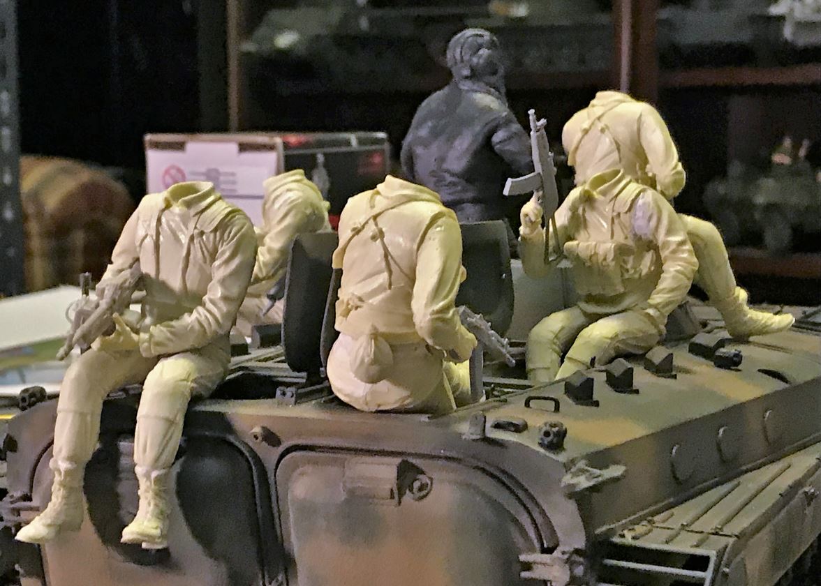

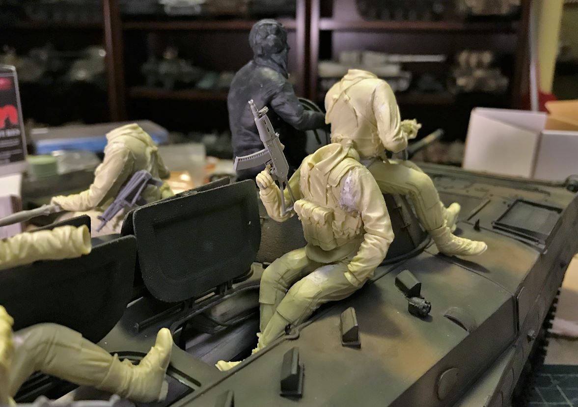

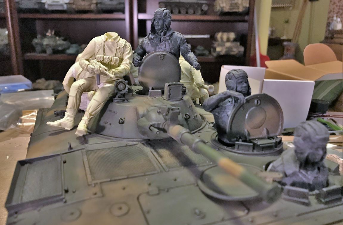

And here are the figures mounted on the BMP-1. Next step, painting.
