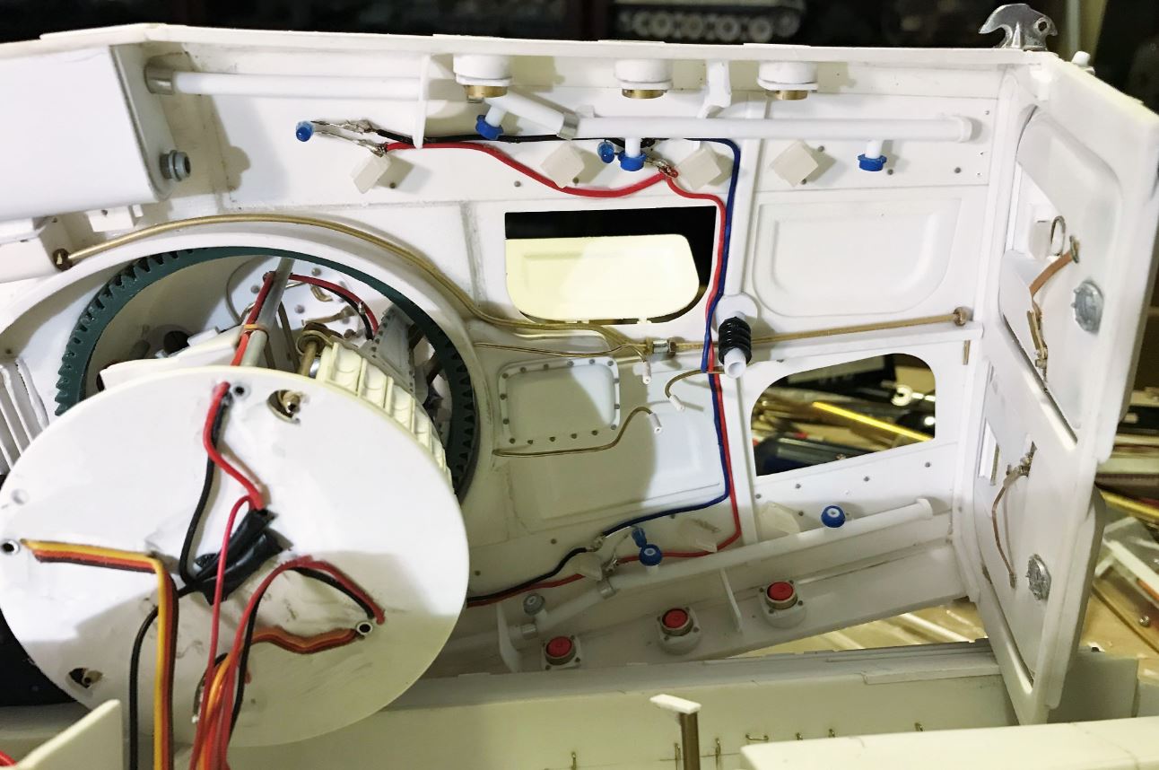

Four blue 3mm LEDs are installed in the crew compartment, more or less where lighting needs to be. Notice the wiring under the turret basket, connecting from the bottom to the front section of the vehicle, with loose cables allowing for rotation.

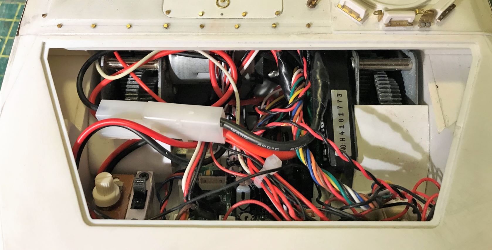

Here are views of under the hood. This is quite basic, with a Clark T-34 TK-22 control board, Heng Long speaker in a smaller custom mount, switch, volume control, Flysky receiver and Zippy 800 battery, but there is room for a Zippy 1000.

Space is a luxury, not allowing for any fancy display of electronics. The showcase is the vehicle with crew interior and turret basket, minus driver area too much at the front.

Access to the electronics, switches and connectors cannot be more simple using the trap on the top front glacis.

The blue interior lighting is a bit weird in the plain white plasticard but I hope it will be better once the interior is painted in a realistic darker color.
