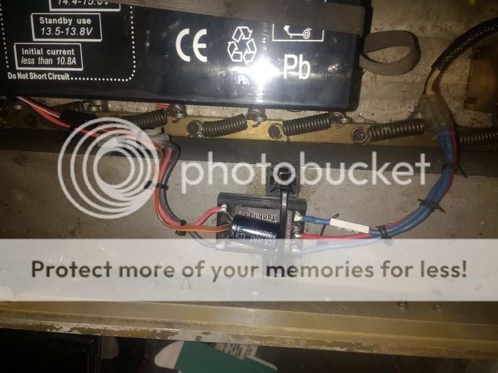

The details are thus,Its a modelworks 1/8 Tiger 1,.
Apparently they were for a small petrol motor and the first had such a gearbox and reduction / 90 deg arrangement .
At some point in the series they acquired a pair of brushless motors and reduction box's
I have the manuals but no details on the motor specs so i measured and went a-trawling through the internet intill i found similar motors ,and they run at 80A to 120A so thats the size of speed control i have gone with,working on the theory that i can program the speed controllers to limit the power output (50% 60% 70% or what ever) and fine tune it with regard to initial torque and so on.
the ESC's that came with it made by Mtroniks Tank and i think 40A will be swapped out before they suffer an unnecessary death in use if what i think above is correct, also i cannot program or modify them and they have a 1 second pause before reverse that is annoying
i have taken on board the comment that thay do not steer straight , this is good to know,thank you.
