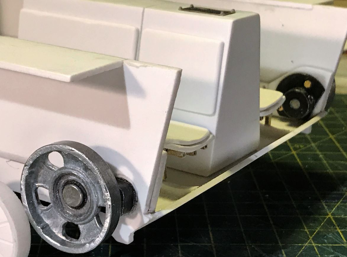

Here presenting the basic interior, minus the electrical cabling, straps, radios and other items that should be added only after painting. By reviewing the pictures for this post, I also noticed a few things that needs to be redone, common with scratch building.
The BMP interior is quite low and cramped. Makes you wonder how tall Russians actually fit in there. As a 6 feet 4 inch guy, I personally prefer the large electric ramp of the M113. Notice the fuel tanks inside the rear door... not a good idea, extra armor would be wiser.

Not a smooth or fast exit under any situation.

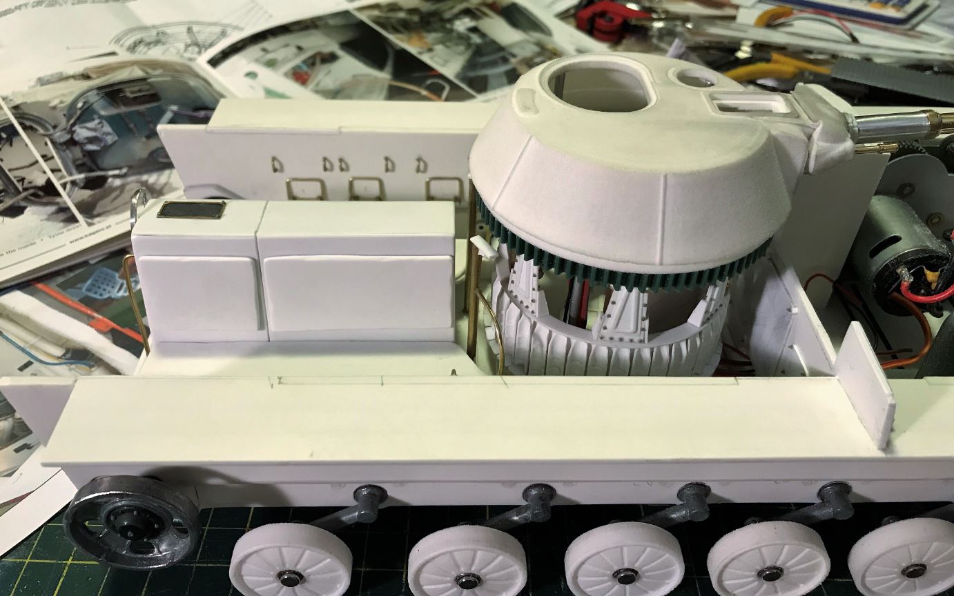

The first task was to create the central module, composed of the main fuel tank in the front and battery compartment in the rear. Sitting on hundreds of liters of fuel in the middle of a warzone is a dangerous position.

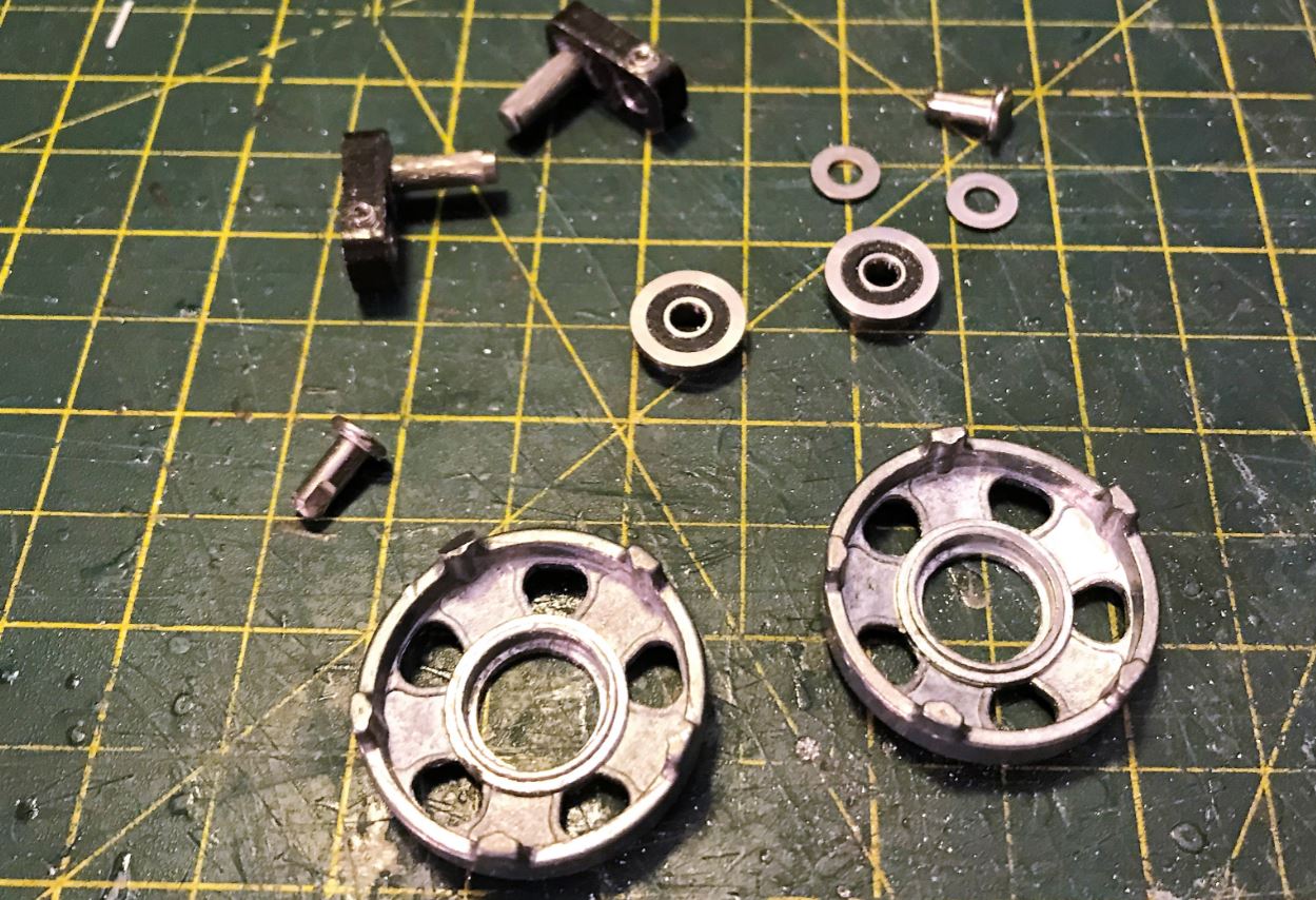

Modified Mato T-90 idler wheels were used, not ideal but at least they have 5 spokes. Once disassembled, the shaft on the exterior half was cut to create the core of a BMP idler wheel.
Ludwigs BMP-1 1/16 RC build BMP
Basic elements for the idler, with a flanged ball bearing at the center and an M4 metal pin as shaft.

Most of the work is actually on the roof.

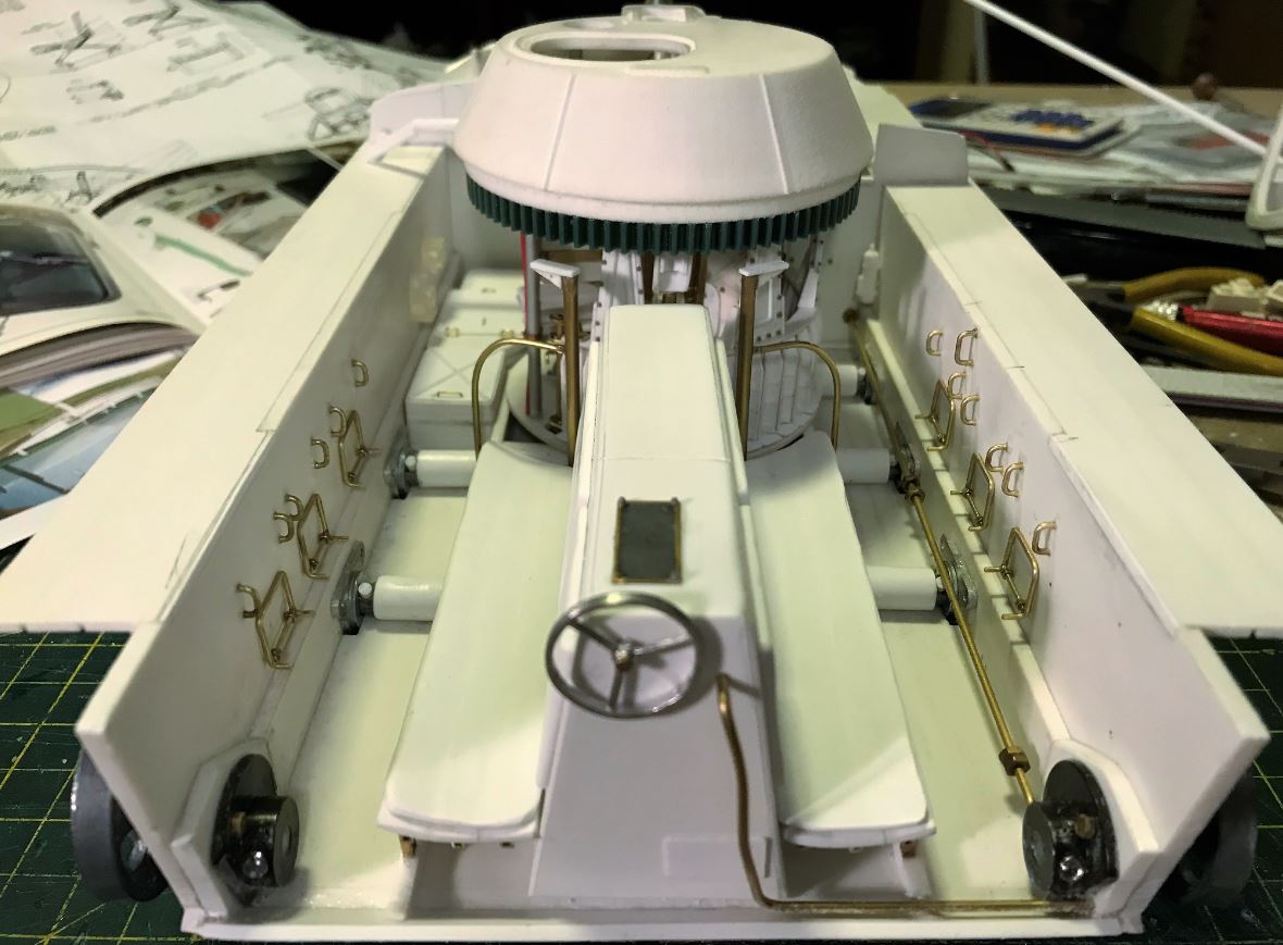

Rear view with the top of the chassis in place. The idea is to have something interesting to look at when the hatches are opened. It will come alive when all the electrical cabling, straps and equipment are installed after painting. It is not fully accurate but it is not too bad. I did more than what I was anticipating. The BMP interior is austere, building it was a learning experience more than a pleasant one.

The large hatches on the top provide good view of the interior.
