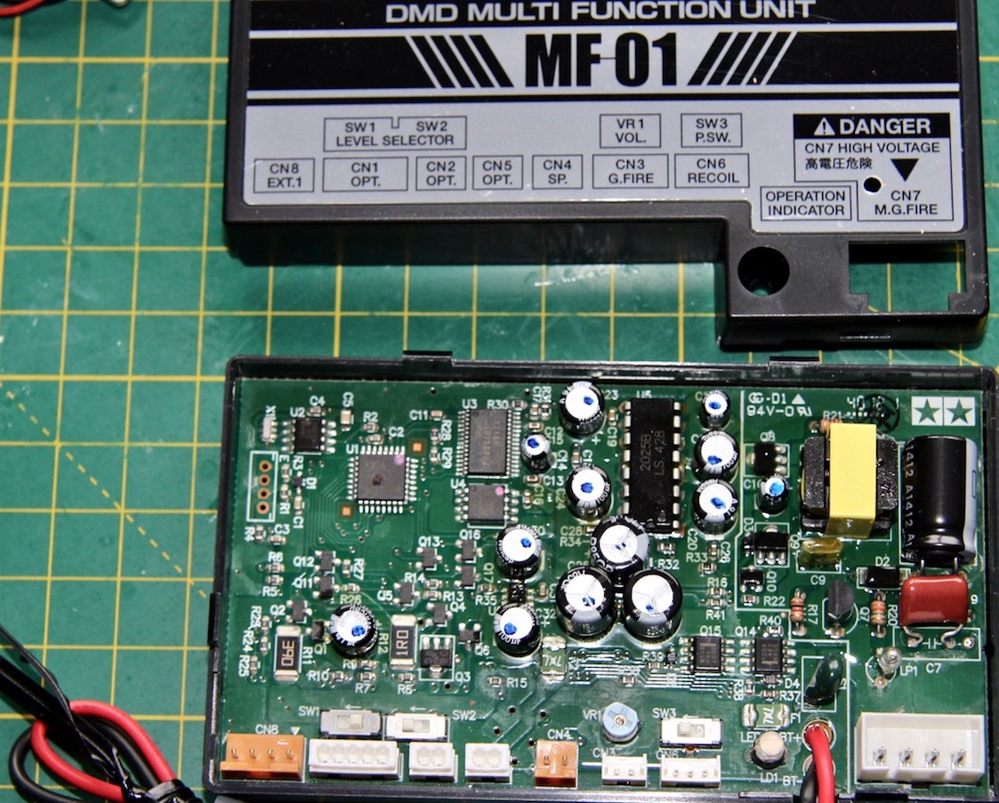

That reminds me, I have a photo somewhere of the printed circuit board in a DMD MFU -01. Must post it here. For anyone with a soldering iron, and a knowledge of PCBs, who happens to have a burned out resistor, or other component it could prove useful.

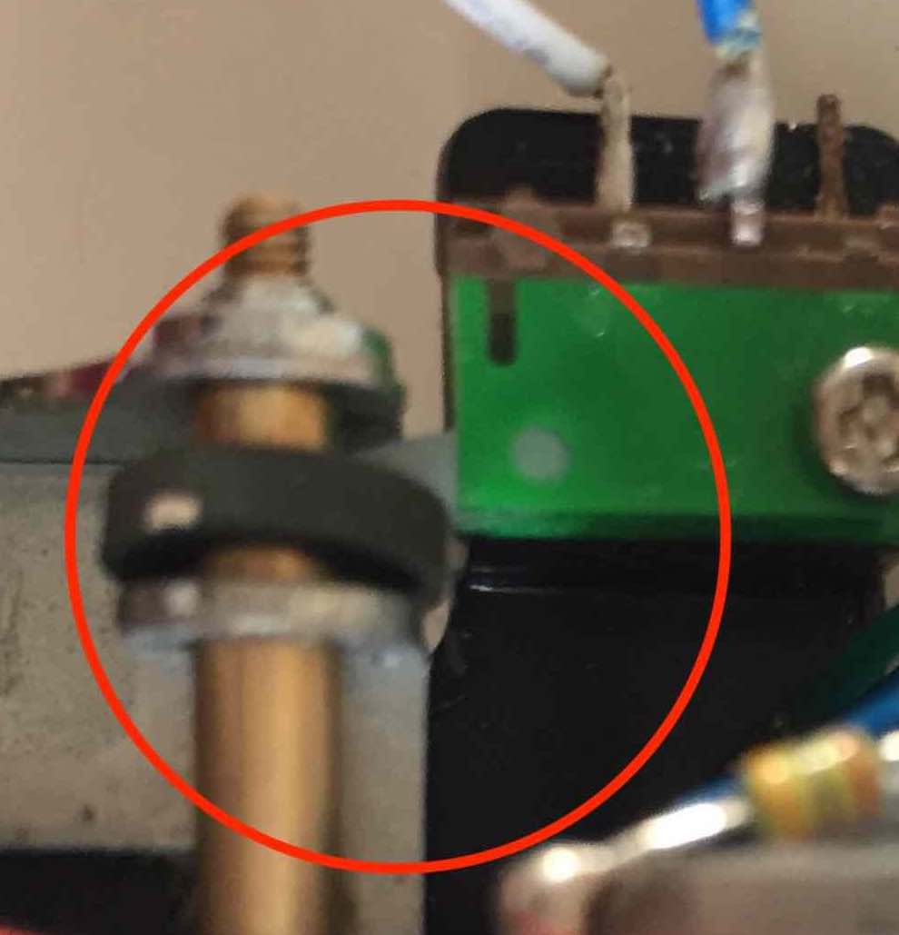

Basically the problem is that the board or the unit sends out a pulse to the recoil unit that is longer than the travel-time of the mechanical movement of the recoil unit. I fixed it with a small rubber ring that forces the recoil unit micro-switch to switch off after one pulse.

As promised. This is a peek inside a brand new Tamiya DMD MF-01 unit. (Fits: Tiger 1, King Tiger, and Panther)
Tamiya DMD MF-01 with case removed
If you click on the pic, it should enlarge sufficiently to show more detail. :thumbup:

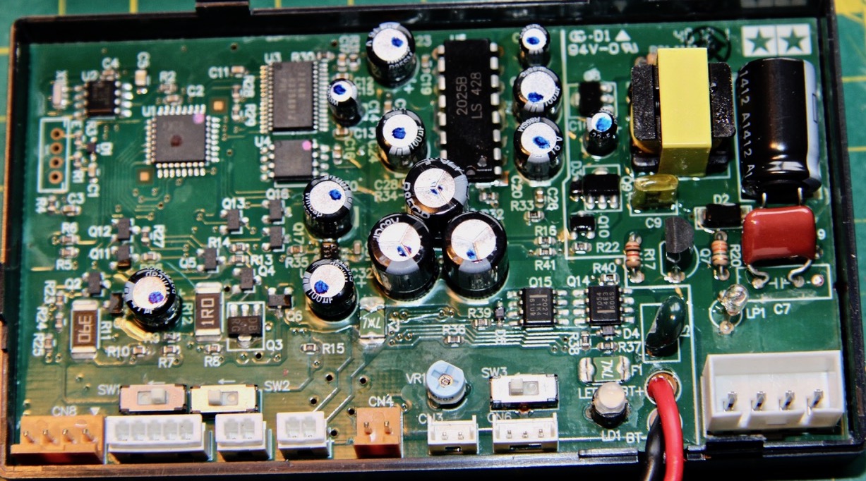

Re: Tamiya DMD/MFU Recoil not switching off
And another, for a closer look at the PCB layout:
Tamiya DMD MF-01 pcb layout
Couldn't get the focus absolutely spot on. I should have used my trusty old DSLR for that. :think: :problem: Still, the pinouts are all labelled/ enumerated.
