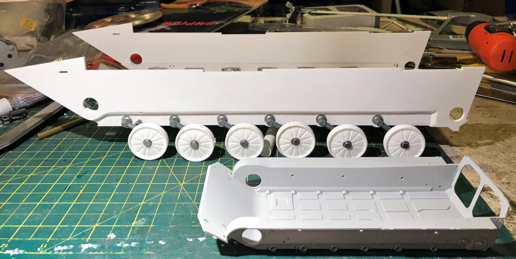

The twelves road wheels are attached to their suspension.
Ludwigs 1/16 RC Soviet BMP-1 IFV build

Suspension is installed. Once the gearbox is put on, I will have to adjust the suspension to make sure the chassis is horizontal and everything is strait. Those torsion bars provide good strength.
View of suspension arrangement.
The lower hull is being assembled. You can see that the gearbox will be way at the front with the first road wheel supporting the brunt of it. It will need its shock absorber to be stable.

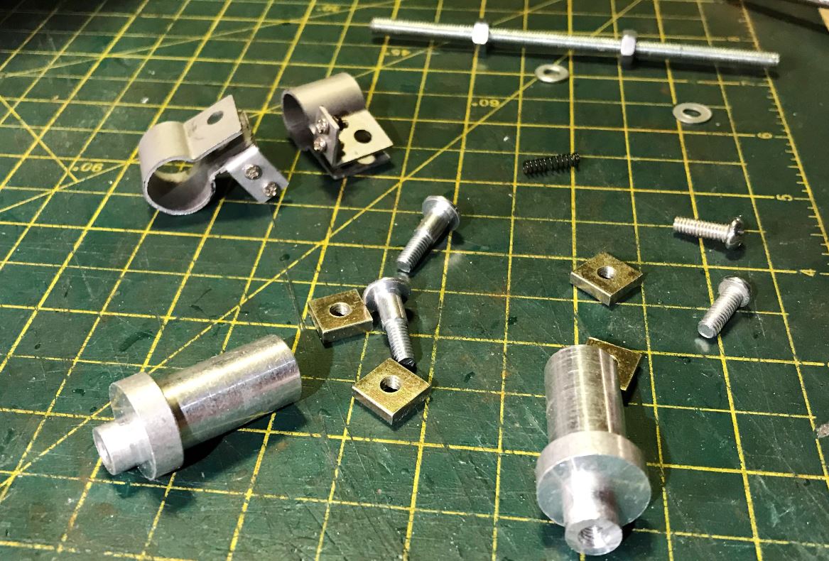

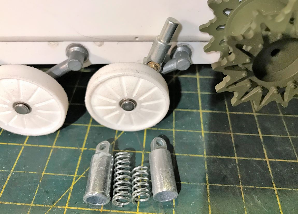

In preparation for the installation of the gearbox, I need to figure out the front shock absorber, in a way that will provide additional suspension support to the front of the vehicle. The front is quite long and will likely need to contain some electronics as well.

I will try to find a picture, but could an H/L PzIII lead arm work with its shock absorber that has capacity for an extra spring inside it ?
Its not a torsion bar, but might be able to work a different way to carry more load.
Re: BMP-1 IFV - Soviet army, Afghanistan 1980s - Build
HERMAN BIX wrote:could an H/L PzIII lead arm work with its shock absorber that has capacity for an extra spring
Thanks Herman, yeah, two of the provided arms by Christian have the attachment for a shock absorber, they were installed at the front. The plan is to put PzIII shock absorbers on them.
Ludwigs BMP1 1/16 RC

The PzIII shock absorber is refined and the spring is shortened. Updated version on the right.
Ludwigs BMP1 BMP-1 IFV 1/16 RC build
With the front shock absorbers installed, I am no longer worried about the ability for the suspension to carry the weight of the gearbox and electronics at the front.

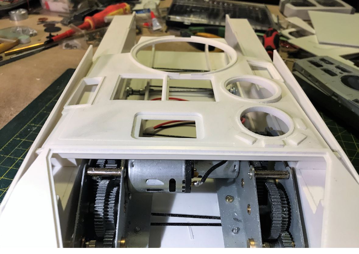

Starting the upper hull. The top needs to be made removable like any RC tank. To facilitate the assembly and placement of the upper hull parts on the lower hull, small drops of superglue are used to keep the parts in place where they connect with the lower hull. These temporary joints will be easily snapped once the structure of upper hull is fully built, strait and solid.
A PzIII gearbox is installed strait on the bottom beams, sockets for the screws were made with plasticard at specific locations, avoiding any contact with the torsion bars.
Some reinforcements are required during the assembly to ensure every part is strait.

Bummer! the top is too narrow and it does not reach the hull sides... I re-checked that everything around was properly assembled. I see nothing wrong with the previous assembly and the angles of the side armor plates fit the Trumpeter kit. It looks like a design flaw. From the couple of pictures available on the Ludwigs website, I can see that the design of the lower hull has changed at one point because it is not like mine. Pictures show 2 variations. I can only guess what went wrong.
When one side is put on top of its base, the other side is missing 5mm to reach its base.
I do not want to change the angles of the side armor, therefore the top needs to be extended somehow. I installed a 5mm wide brass strip on both sides to create a bridge. With putty and some adjustment of the ventilation holes, it should be ok.
