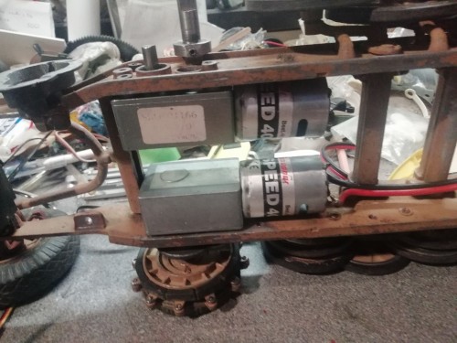

Had problems with the gearbox its basically worn out and I got no joy from Asiatam regarding replacements despite several emails and a phone call. So I decide to make my own or at least adapt something to suit

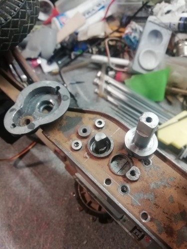

I found some 90 degree drive gear boxes on ebay for 3.95 each. The shafts needed lengthening and a bearing fitting in the outer housing. My good friend Pete did a great job machining an extension piece
I'm manning the gun's ! Who's driving ?

The boxes themselves have a smaller 12v motor so i machined the case to allow a speed 400 to fit and rebored the worm gear for the shaft to fit the new motor these now fit in the chassis frame

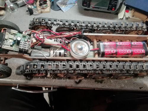

The outer housing and the shaft took a little work to align and run straight but a quick re test with the gear sitting on the chassis showed it all moving as it should. The speaker reciever and clark board all fit under the bonnet
