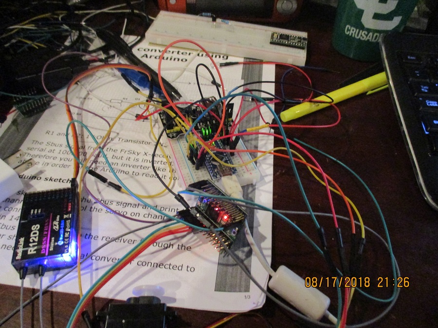

Did some more work on the code. I can now see six channels (soon to be 10) all arranged in nice neat rows and columns. Also, set some outputs like CANFIRE Cannon fire channel 5) and T-FULL (full throttle channel 2) when PWM signal is received at right frequency. Still at the very basic level...but working enough to test Tsunami sound board...
And the wiring is getting more spaghetti-like....

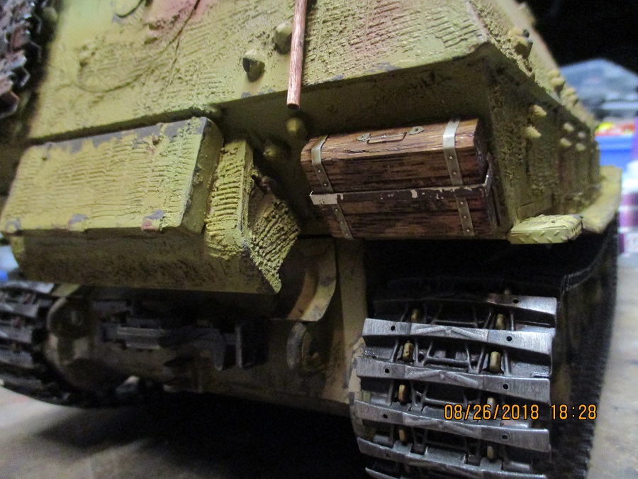

Machined rear center hitch from one piece brass. Sheet metal for the electric motor cooling deflectors. OEM was 3 piece, but easier to make as one. Tow eyes brass and 3D printed centers. Jack and mounts modified from king tiger....

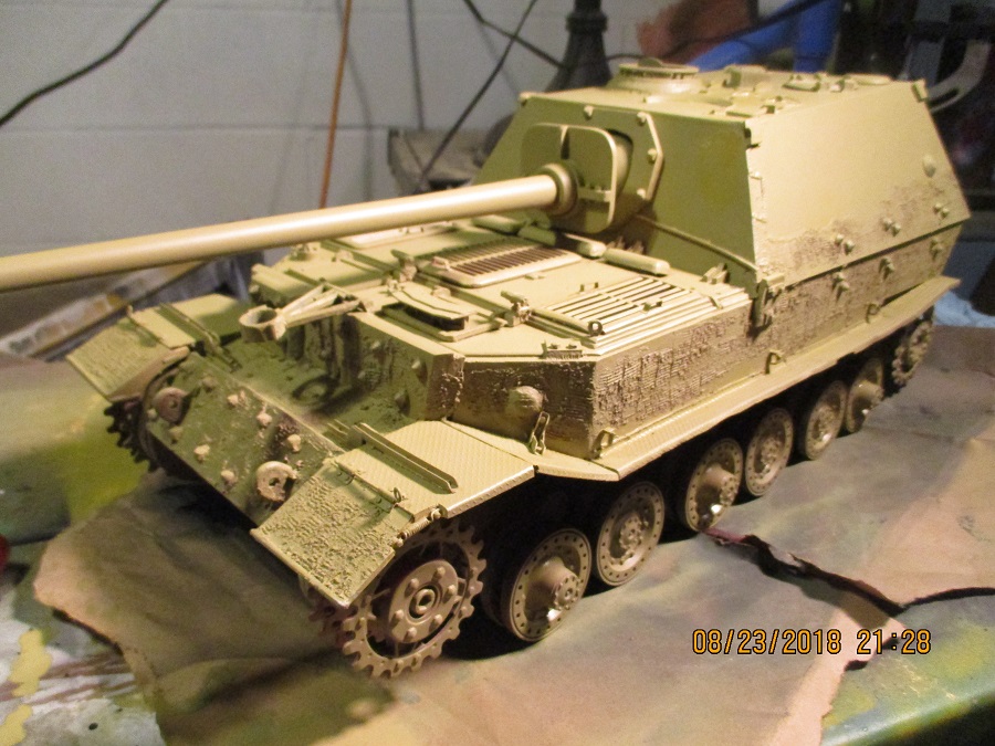

at paint station....few more details to go..
rear hitch plate is bigger than oem due to the way I have it hiding the two pre-cut slots in the hull. It will be mostly hidden by the jack.

Hi Herman! Thx for the post! You are correct. And it is really cool to see all the necessary designs to get the whole Elefant tank operational. I finally got my 16 Channel SBUS to PWM code functioning :D So basically, I can now divide throttle position into any number of steps needed to play .wav files. I have figured out how to add a timer delay into the main gun CANFIRE section of the code without adding a delay to the code (which is not an easy task for someone who does not do this often). Say you fire the main gun, well then there is a 3+ second delay before you can fire again. If you try to fire again before this, well then you are back on the 3+ second waiting list. Would definitely add some tension to IR gaming! I guess I could also write into the code a limit of 60 shots, but comprehensive tank code is not what I am after.
The rest of the code is really pretty simple, just ON/OFF to trigger .wav files. The Tsunami .wav board never arrived and I think it got lost in the mail. I have requested another be sent. Hopefully I am not out 79$!
Here is a pic of the serial monitor:

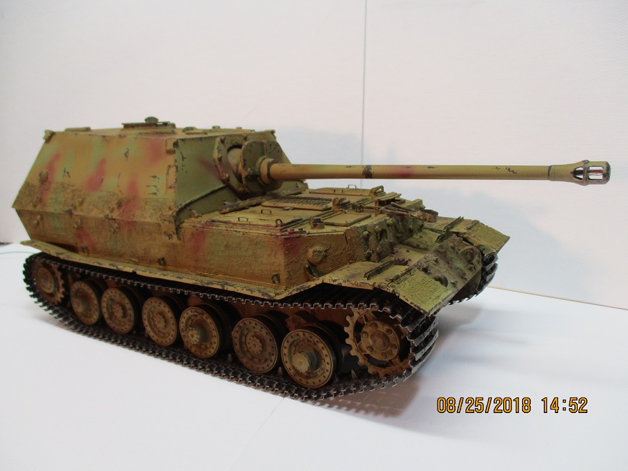

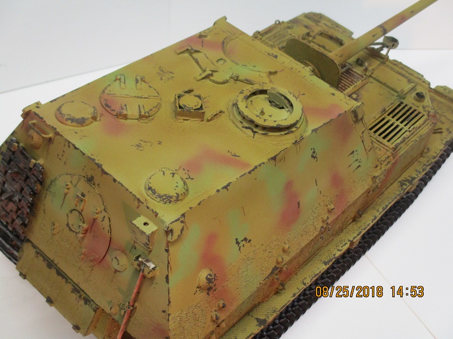

Did some washes and some color....few more details to go... lighting terrible for pics...
Tracks are a bit snug, had to take out one link. They will loosen up with a bit of use, and I can further loosen the tensioner .

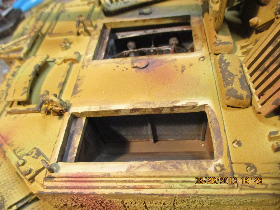

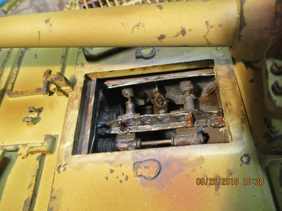

a few more details.....
Re: 1/16 Elefant Ludwig/Asiatam
Fantastic job :thumbup: love the inner workings picture. You have done an amazing bit of work :clap:
