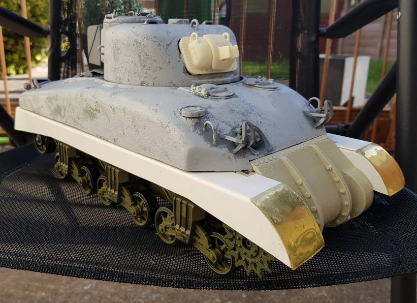

Re: MATO M4A1 upper to HL Lower
Post by Model Builder 4 »
Here are the said modified Sherman's using mato uppers while works in progress
Cheers, Lee.
Sent from my SM-G950F using Tapatalk
Model Builder 4
Posts: 2428
Location: South Wales valleys

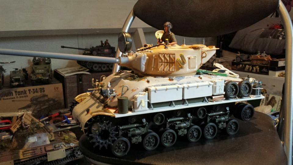

Model Builder 4
Posts: 2428
A more updated pic of the M51 using the mato upper Image
Cheers, Lee. Image
