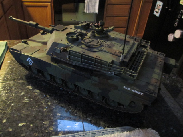

I'm improving and converting an unknown make M1A1 from 27mHz to 2.4gig for a mate.
Cosmetically this involved repairing a broken 120mm gun barrel, replacing the inacurate spare wheel with a correctly detailed cover on the turret roof, correcting and redetailing the commander's cupola and making some stowage items.
The stowage items includes 4 home cast small ALICE packs, 4 sleep mats made from 2mm foam sheet and so home printed MRE boxes. These are just set on the turret at the moment.

Good morning,
You have yourself a HobbyLink M1 there. Very good start on reconfiguring it for accuracy! If you check in the subforums here from years back, you can find notes and pics from Ian \ Tankbears extensive rebuilds of this brand of tank. My first tank was one of these bought used on EBay for 69.00 U.S. I ran it for years with no issues until the tracks wore out and a gear in the turret turn mechanism lost a tooth. I bought a new gearbox online and Ian sold me new tracks and I gifted the tank to a Friend who is still enjoying it in stock form. Enjoy yours!
