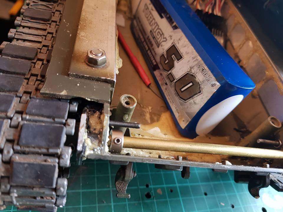

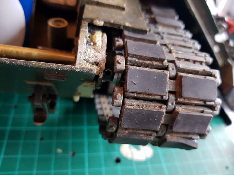

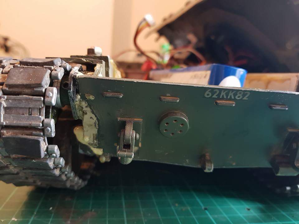

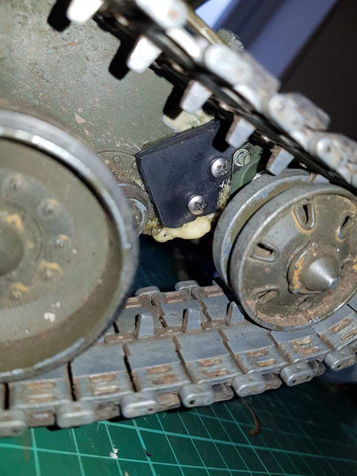

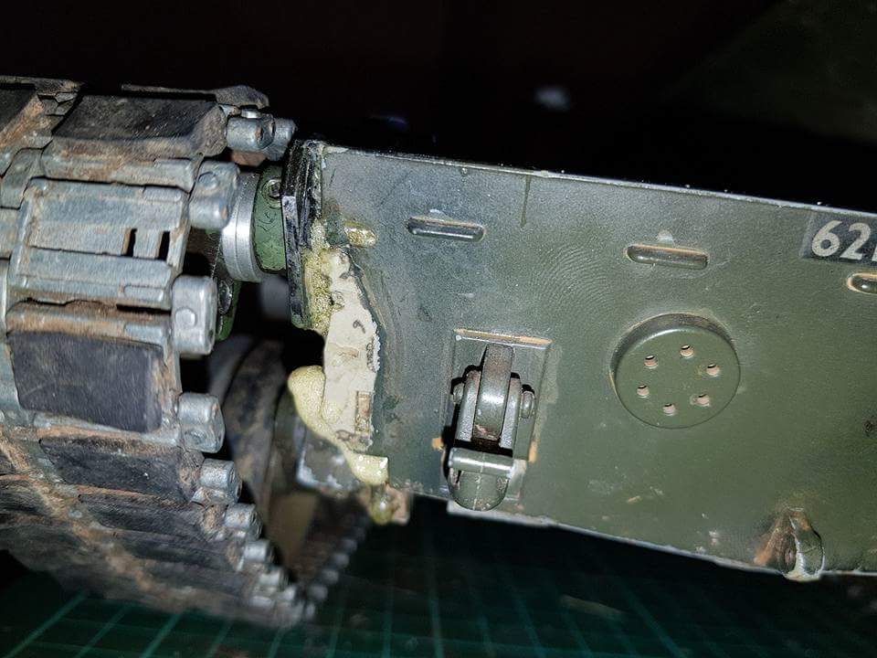

So here's some photos of what I destroyed and the botch I did to fix it, not pretty but it works!
Destroyed idler I guess upgraded drive train was too much
Had to grind back some of the lower front Hull plate and then plasticard spacers to bring the idler out in line with the track guide horns
You can see the plasticard spacers bolted and glued to the side Hull here, at least there out the way!
