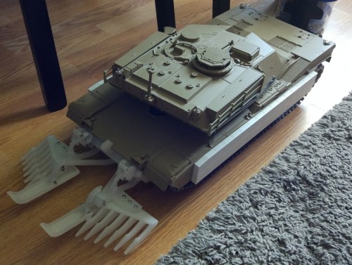

Finally drilled 4 holes to mount mine plow. It will be controlled via transmitter. I will connect it to internal ESC in OP board.
