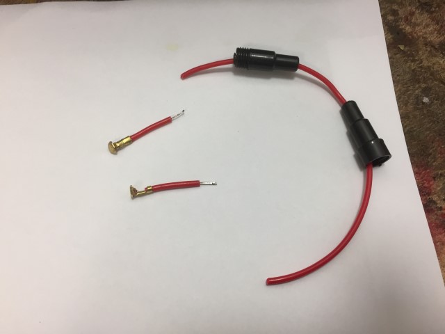

Adding a fuse to main Power
I shorthen the wires on the fuseholder for better fitment into the hull

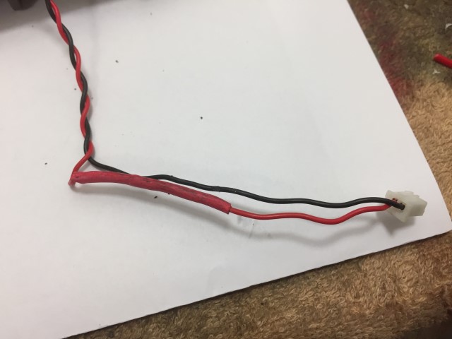

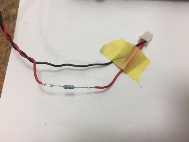

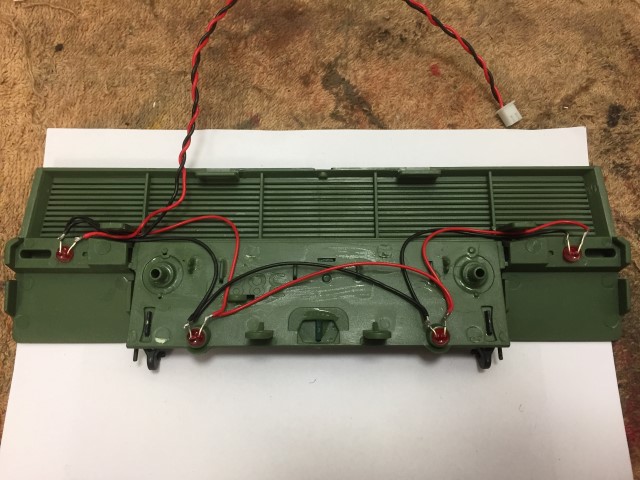

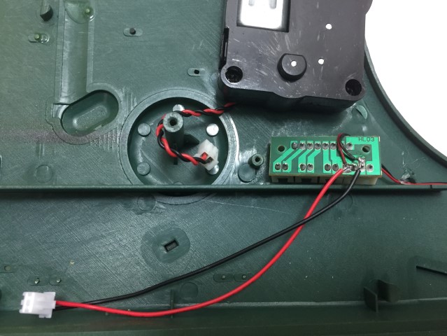

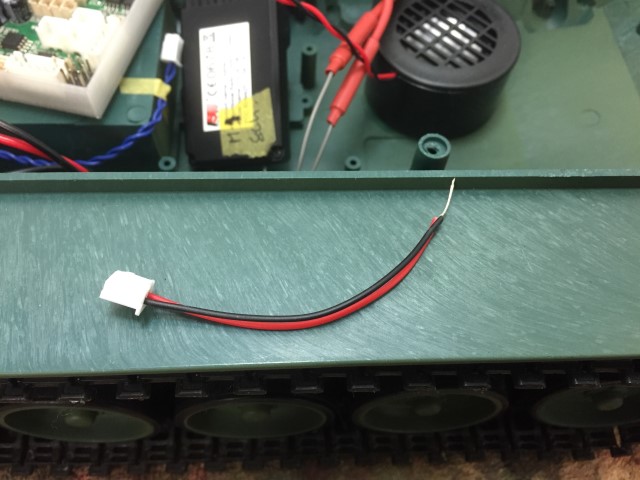

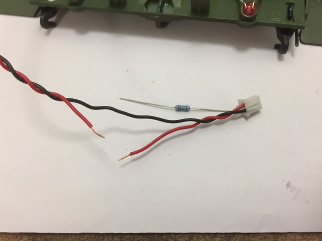

adding rear light to CN9 output ( + resistor )

maxmekker wrote:adding rear light to CN9 output ( + resistor )

Yeeees! More updates.
I pray I do not f*** this up.

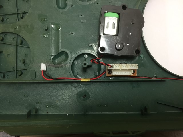

I did something. I hope I didn't do it wrong.
(Send help)Image
Sent from my Phone using Tapatalk

as long as the solder points dont melts together you're fine :thumbup:

I can't seem to find the resistor you gave me; I know you did because I saw it.
I hope I didn't misplace it. :shh:
