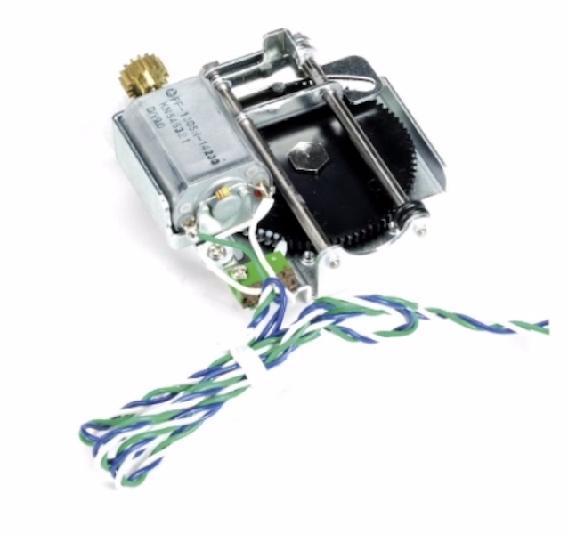

Thanks for the info . If i take an average figure its about 30 mm travel . Fitted at max travel the servo hits base of turret ring before max gun elevation. Going to move servo forward and fit a smaller gear. Better check my Tamiya KT recoil , it may be wrong as i think the barrel has a long travel. Does Tamiya use the same recoil unit for every tank ,perhaps they only change the fixing points?

One Tamiya recoil unit p/n 4205024 is used on Seven of their Full-Option tanks, including the Panzer IV.ronnie42 wrote:Thanks for the info . If i take an average figure its about 30 mm travel . Fitted at max travel the servo hits base of turret ring before max gun elevation. Going to move servo forward and fit a smaller gear. Better check my Tamiya KT recoil , it may be wrong as i think the barrel has a long travel. Does Tamiya use the same recoil unit for every tank ,perhaps they only change the fixing points?
This means the HT barrel travel will differ (as it should) from all other models, with the exception of the Jagdpanther. Ad Lav has one of those, and maybe he could confirm the recoil distance. My Tamiya KT is partially dismantled at the moment, otherwise I'd measure the barrel travel for you.

Charged a battery, wish Tamiya went down the lipo 3c route like IBU and Elmod where you can dial in battery type and voltage. Recoil is 35/36mm lines up with 1st groove. Wonder if recoil is voltage dependant , new charged battery giving max recoil?

If you look at this pic of the recoil unit (they all look alike, irrespective of Tamiya model), you'll see that the travel limits are determined mechanically by gearing and end stops; not electronically..ronnie42 wrote:Charged a battery, wish Tamiya went down the lipo 3c route like IBU and Elmod where you can dial in battery type and voltage. Recoil is 35/36mm lines up with 1st groove. Wonder if recoil is voltage dependant , new charged battery giving max recoil?
