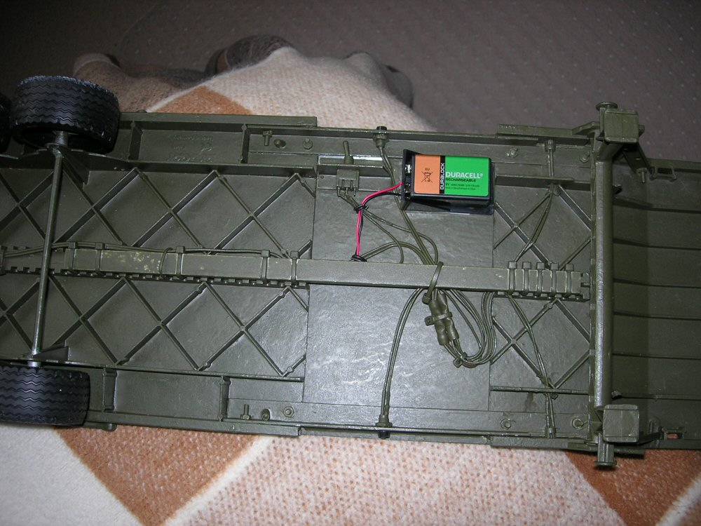

I did consider doing something similar to the vehicle above and started with dolly wheels on the front of the trailer..... I still have the dolly wheels. Reversing with dolly wheels will be a challenge...lol
The trailer started as one of these from Bruder, see ebay link below. Extended by 4 inches and lights added.
https://www.ebay.co.uk/itm/Spare-Additi ... SwywRZ9HFB

Heng Long 6 Wheeler Truck & Tank Trailer
Underside of trailer with 4 inch extension and electrics for lighting
