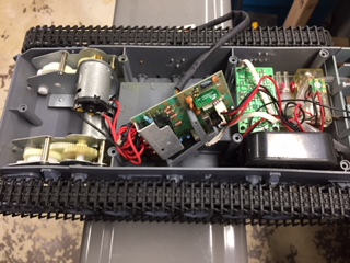

Hi all,
I first want to apologize for asking this question. I've searched this forum, and I'm sure the answers are here,
but I'm afraid being new to the electronic board names, numbers, I'm overwhelmed with info. My issue is that I have a Heng Long
Panzer III It's old. it has a TK-RX13 in it. I just want to get it upgraded to a 2.4 radio system. I've read here where, I cant use the HL
2.4 conversion kit without a lot of re soldering/wiring? I'd like to keep the conversion as simple as possible, although I realize that might not be the cheapest way. I'm at a loss as how to proceed. :crazy: Any help would be greatly appreciated.

It will cost a little more, but transform your tank. Think about fitting a Clark TK22. You will need a 4 channel 2.4ghz tx, but they are pretty cheap, and you can use the same tx for all of your tanks.
The cost of an HL 2.4ghz tx and an RX18 is going to cost almost as much, and the tank won't be much better than it is now.
They are easy to install, though you will have to solder HL plugs on the end of the wires that are in the tank, but you would have to do that whichever route you take.

To convert your Panzer111 to 2.4 GhZ will cost before postage $102.65 and I promise that it is probably about the cheapest you will be able to convert to 2.4 GhZ and at the same time the most upto date.
Go to---
www.forgebeartanks.com
Click on Store then click on Electrical,
The top left hand corner item is what you are after,
It is a Complete Boxed Taigen 2.4 GhZ Transmitter with a V2 Control Board an Upgraded Speaker, a Sound Module, (Do specify Panzer 4) Wiring and an instruction sheet,
Label every pair of cables that are soldered to your hard wired Control Board then using a soldering iron detach the cables from the board,
Set the board aside you will no longer have need of it,
READ THE INSTRUCTION SHEET and check each socket on the V2 board to make sure you know what goes where then with the new cables with their plugs at one end pre-fitted, solder your labelled Cables to the new correct cables free ends as per the Instructions ,
The Speaker and the Sound Module can be plugged into the V2 straight away without any more work,
It will transform your old PZ111 into one that is as upto date as anything on sale right now,
Dave (Forgebear) Exports across the world and is a trusted Dealer and member of this Forum, :thumbup: :thumbup:
As members of the European Union (For Now) all dealings are taxed 19% VAT,
As a Resident of the USA the tax does not apply to you so that your postal charges will make the upgrade because it is Tax Free about the same price as it would cost a European Purchaser paying Tax AND Postage.
Shaun.

The cables with the Taigen boxed upgrade are not the ones to connect to your PZ111 Cables you need to go to ---
www.welshdragonmodels.co.uk
Click on Upgrade parts for Heng Long and Taigen Tanks then click on Misc including Electronic Parts you want the 2.4 GhZ Cable set for Heng Long and Taigen at £4.99==$7
Sorry about the confusion.

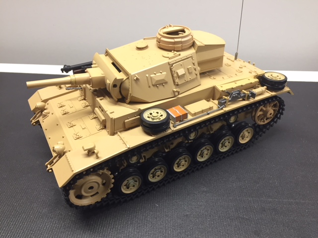

I definitely need to be able to use on multiple tanks. :clap: I also have this Tauch Panzer III that is 10+ years old,
but has the original 72 MHz radio, and still works good, but is a little jerky on the controls.
