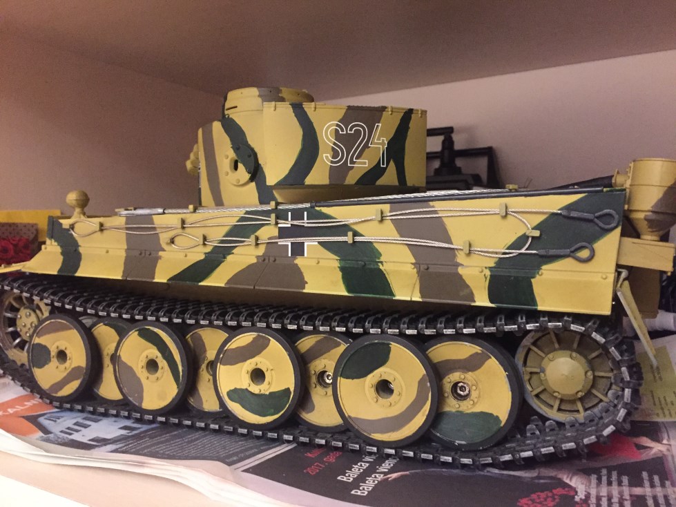

I have an early Tiger 1 with Taigen lower hull with torsion bars and other good stuff. The one thing that has been bothering me since the very day I bought it is the position of idler wheels. They sit too high for historic accuracy and also for decent track clearance. Has anyone found it a problem and how to fix it?
All early versions of Tiger 1 have the centre of the idler wheel roughly at the same height as the centre of the roadwheels. On this Taigen hull it is not possible. Adjust what you may the idlers are still way higher that the other wheels and the clearance is very small at the back. It may even get worse if you increase track tension they may start hitting the hull release screw on the left side.

Thanks, just browsed through my pictures and realised that I dont have any decent pics of my Tiger. Just a bunch of garage shots on a newspaper... I guess my life story will need to come later.
As concerns the height of the roadwheels, Im sure you are right about the top alignment. I have seen some tanks where the centre is aligned to roadwheels, including on pictures of the incredibly good and expensive Aero-mate Tiger. Being on the same level would be fine for me. But the tracks sit higher at the back. It is typical of late edition Tigers but not early.

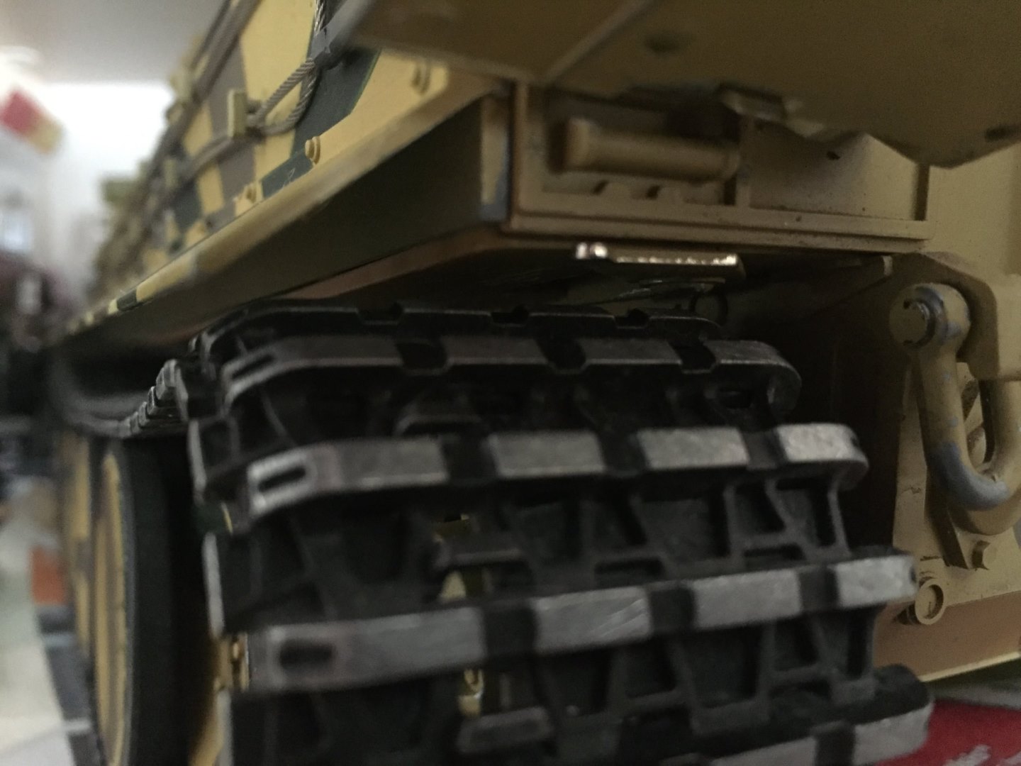

A close-up of that area

Last night I went for the obvious thing and removed one track link from each side. That did help lower the idler position as it now stands closer to the rear set of the roadwheels. Still it's not level with the top of the roadwheels. It may even be the case that the suspension arms are too high. It looks ok when I press the bottom part of the tank down.
The HL chassis is more accurate in this respect. I have a track tensioner installed and with that the look is perfect.

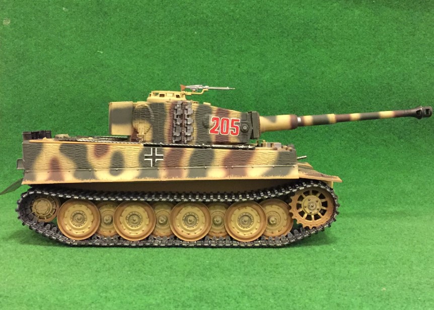

Until I saw this thread, I had not even considered the idler wheels.
This is one of my Torro Tigers.
