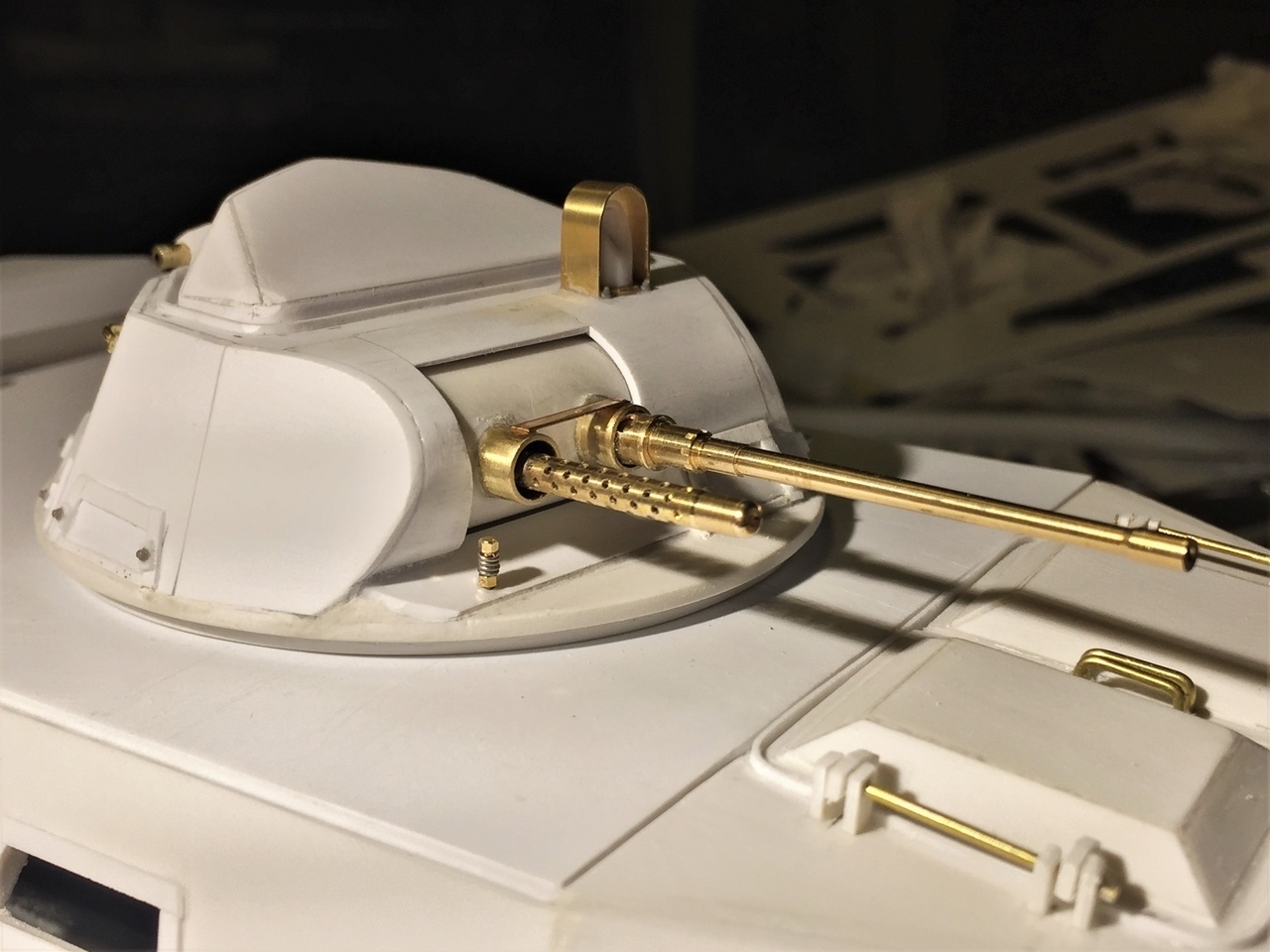

This is the turret, part 2.
The T50 turret is finished, mounted with ABER .30 and M2 .50 machine gun barrels. I looked around for flash suppressors for these but did not find any. These would be very delicate, i will see what I can do.
Ludwigs 1/16 V-100 Commando armored car
The cupola hatch looks simple but it is actually a complicated design to reproduce, so many angles. I did my best to capture, interpret and reproduce the design from pictures and few drawings seen here and there. Doing a better job would have required accurate blue prints. Good enough I think.

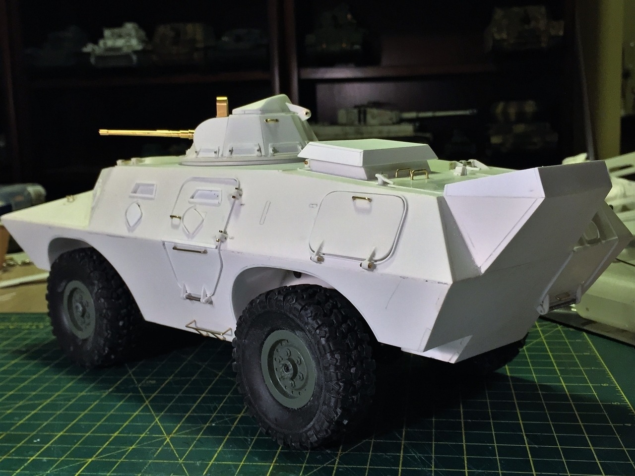

With all core components built, now the focus will go to the electronics, install the speed control that I just received and do a test run. Then create the headlight, tail lights, install the turret permanently, create rotation and gun elevation system, sound. And after that, go around the vehicle, create and install the various small and fine details still missing, and build the 3 figures. Still a lot to do... It's going well and I enjoy building this model very much.

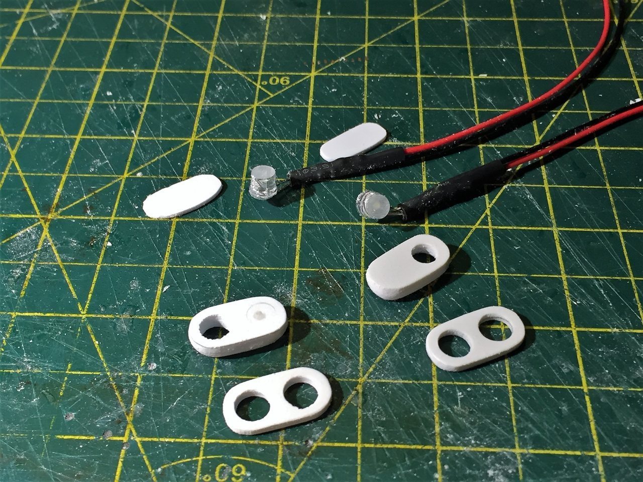

This is the frontal section with the headlights
This is what the V-100 builder needs to create. The brush guards are easy enough but the headlights themselves have a unique shape that have to be entirely scratch built.
Ludwigs V-100 Commando
An inexpensive LED kit was used for the lights and connect directly to the receiver. The LED was shortened to fit the headlamp body. Core parts were created with residual plasticard, one thing that you get plenty of when you build a Ludwigs kit. No need to pick into the plasticard reserve and enough for quite a while.
The headlight forms are made of layers of plasticard.
They are hand crafted on a best effort basis with basic tools, no way around it.
Headlights are Installed as well as other details around them, it was a 5 hour operation end to end.
