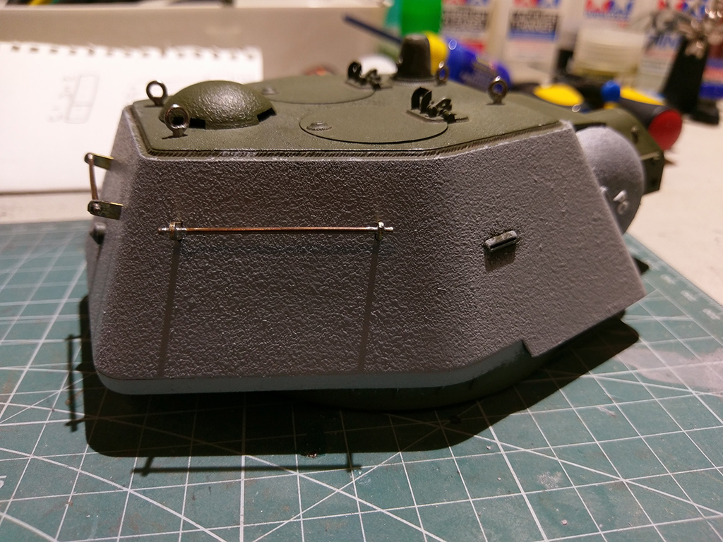

Cutting the slots for the metal handrails made a bit of a mess of the turret sides, and puttying up the gaps just made it obvious that something had been changed. Naturally, this culminated in retexturing the entire turret with a few coats of Mr. Surfacer 500 stippled on with an old stiff brush.
I figured while I was at it, I'd use some Tamiya putty to emphasise the rough cast texture on the turret cheeks and add some casting markings. For the curious, the numbers are my wife's birthday and the letters are her initials in Cyrillic. Sometimes I can be sentimental like that. :{
I'm hoping the weather will improve during the week, it's been too hot to start priming yet. It looks like we might be due for a cool change later in the week, so I'll keep finding busy work until then. Those stowage hoops could probably be redone in metal, after all...

Re: Trumpeter/Taigen hybrid T-34/76 (obr. 1942 model)
Love the extra texture touch mate.............and the casting numbers & letters, well, some days it really is the little things that can mean the most :thumbup:
