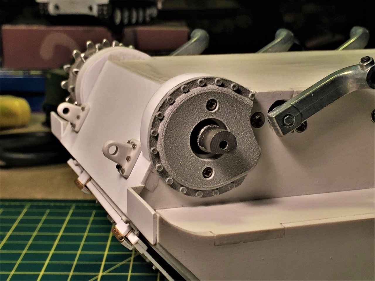

This is the drive cover area.
The Shapeways.com Sherman drive covers were cut in a round shape to fit around the drive shaft and suspension arm. The area that was cut is hidden behind the sprocket and won't show. I've found the remaining round area is of perfect shape for the M113. At $7 each, they are quite expensive for what these are but it is at least something I do not have to scratch built, a rare luxury.
M113 gearbox drive cover
The front hooks were made with the part provided with the kit. However, the hooks were modified to be strait and not curved. I also removed 2mm in height from the base. Nuts are from Meng.
Scratch building the gearbox external housing takes some effort. it is made with 1mm plasticard strip, shaped to go around and follow the shapeways drive cover. It is much easier to run the main part strip first against the corner of a desk to pre-shape it with the required curve, and warm it up just a little. The small overlay part is made with thinner card.
The frontal area is highly visible and this is the look I was looking for with the sprocket on. Notice that I started to file the dents of the sprocket. Now it runs much better with the tracks on.
Front area is completed.
