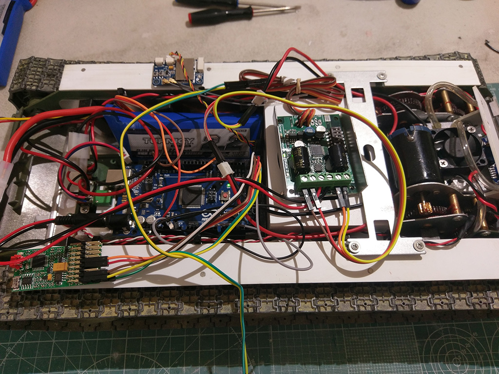

I'm not having a go at you Shaun, but that's kind of reductive. I'd say there's a reasonable overlap in the Venn diagram between people who enjoy RC modelling and people who are interested in electronics. For me, at least, I want to make something that's as prototypical as possible; it's no good for me to make something that looks like a tank if it doesn't behave or sound like one. The current aftermarket offerings all have their limitations in one respect or another, where flexibility and customisation are key. Having something more powerful to oversee all of that can't hurt.
Tiger111 wrote:So my main questions are; would it be possible to create my OWN motherboard out of the pi3? Would it be possible to bind the custom motherboard to an RC transmitter? And finally would it be possible to purchase electrical components to make a Plug and play board, not each unit being soldered on? If anyone has any knowledge of this particular subject, feedback would be appreciated! :D
It would certainly be possible; the Open Panzer project uses an Arduino Mega 2560 to control all of the tank's functions, and it's not as powerful as the Raspberry Pi.
  • Image
You'd be able to make a breakout board or something that has all of the connections for the tank (they're just JST-XH connectors, you can get them online for cheap) so the Raspberry Pi could control them, you wouldn't need to make a completely custom board. I'd recommend looking into the Open Panzer project, the code is all open-source so you can look through it and see what will work for you, especially for the groundwork like radio communication and motor control.
