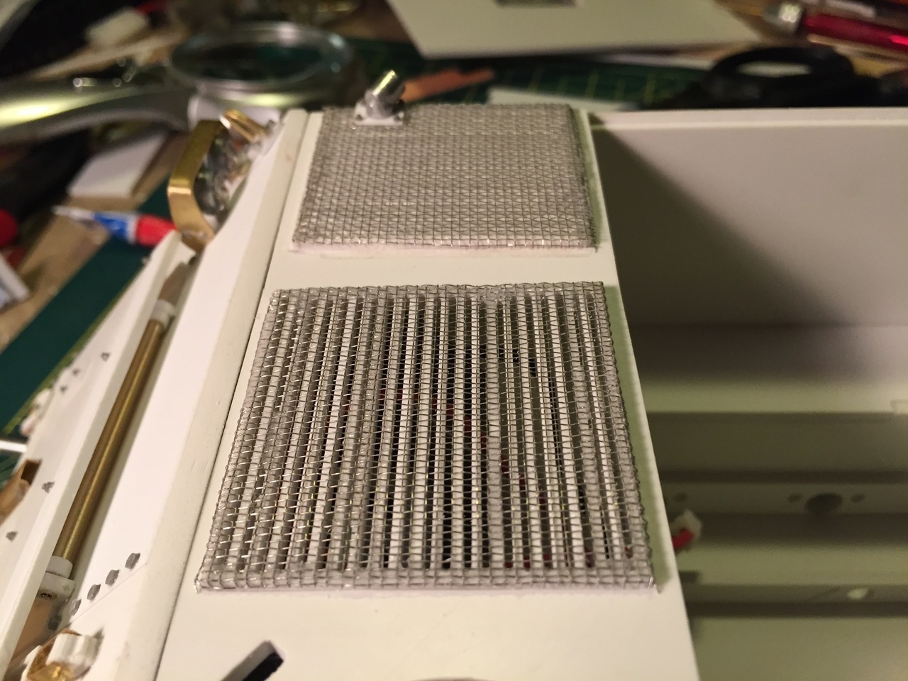

I therefore decided to built a new left grille as per references. I used leftover plasticard from the kit sprues, one of them is of the perfect thickness for it, cut some blades and assembled them with superglue. It is easier than it seems to be.

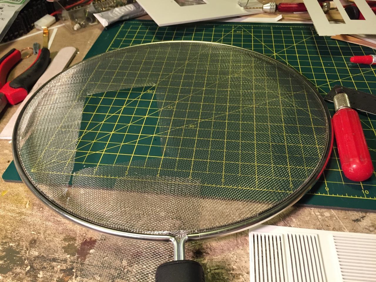

An important component is the metal mesh that goes on top of both. I stopped at the dollar store of the way back from the office and bought this kitchen instrument for 2$, the mesh was of good size and of a rectangular shape, perfect.

The grilles are installed and look good compared to references. I made the mesh a bit larger on some sides in order to curve them around the edge, like i saw on pictures. The top section was not glued to the hull. Need to keep this removable til the end of course.

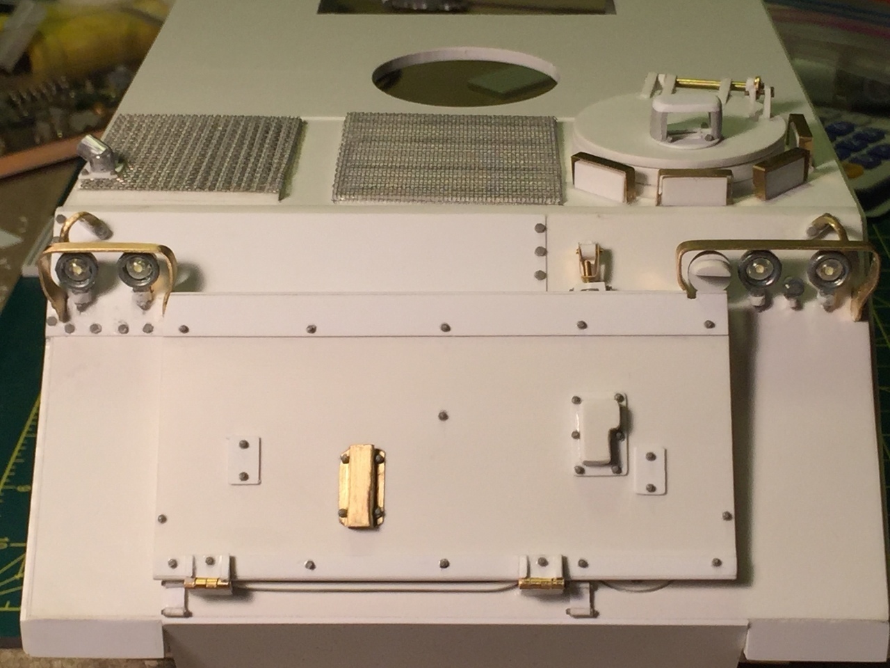

This is the driver's hatch. As per Squadron M113 walk around, the hatch has four M17 periscopes on the sides and one M19 on top.

Overall view of the driver's hatch.

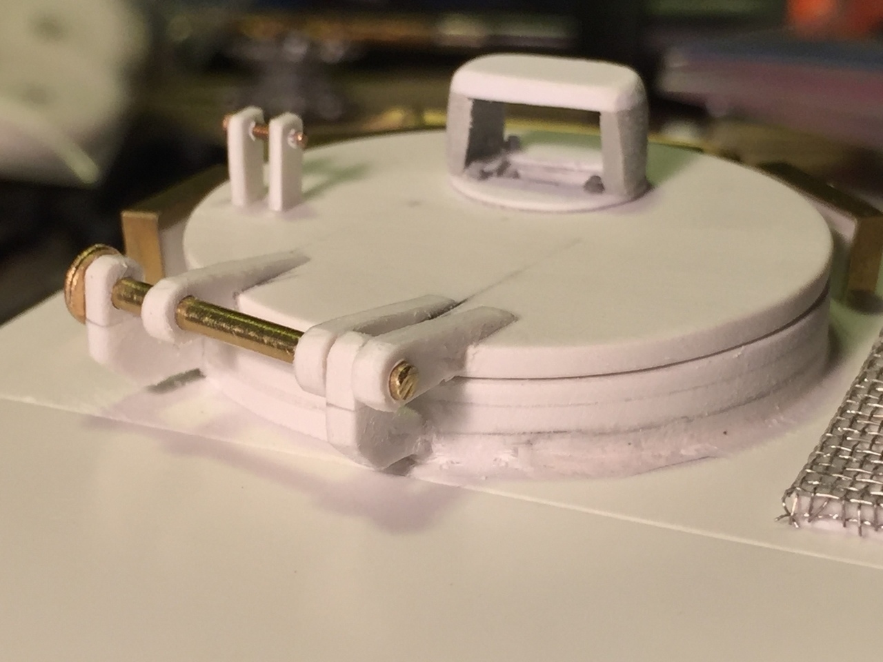

I tried to reproduce the production hatch hinge arrangement as best as a could, reusing some parts provided by the kit, the rest is hand made from plasticard and a simple brass rod. This was quite fun to do.
M113 driver's hatch
M113 driver's hatch
That third bracket on the right attached to the hatch is not provided in the kit and needs to be scratch built.

The hatch can be opened of course. I am planning to show a driver. However, I have not yet finished the interior of the hatch. I am still searching for a good picture showing the location of the handle and of the locking mechanism in order to reproduce them. The hatch will be left open. I have not seen any reference picture of M113 in storage or in the field with the M19 periscope installed.
