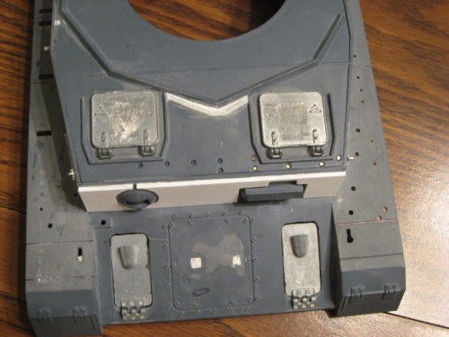

philipat wrote:Got some more work done on the upper hull.
Hatches: all of them have a support shelf installed using styrene sheet and a 2x1-mm disc rare earth magnet for each hatch. I cut a small piece of steel from frozen juice can lids and glued it to each hatch right where the magnet is. The magnet is strong enough to hold the hatch closed, but not make it impossible to open it.
If you don't mind me asking, how did you secure the hatch hinges to the hull? I've just got a set of metal hatches for my Tank & there doesn't seem to be a secure method of attachment?

Sorry about the delay. I had to open mine up to look.
The back of the hinges have posts. I drilled holes into the hull for the posts. Then, I glued the hinge in place using JBWeld (https://www.jbweld.com/products/j-b-weld-twin-tube). Let the epoxy sit for at least 24 hours before trying to handle the hull. 48 hours is even better; more than that isn't necessary.
