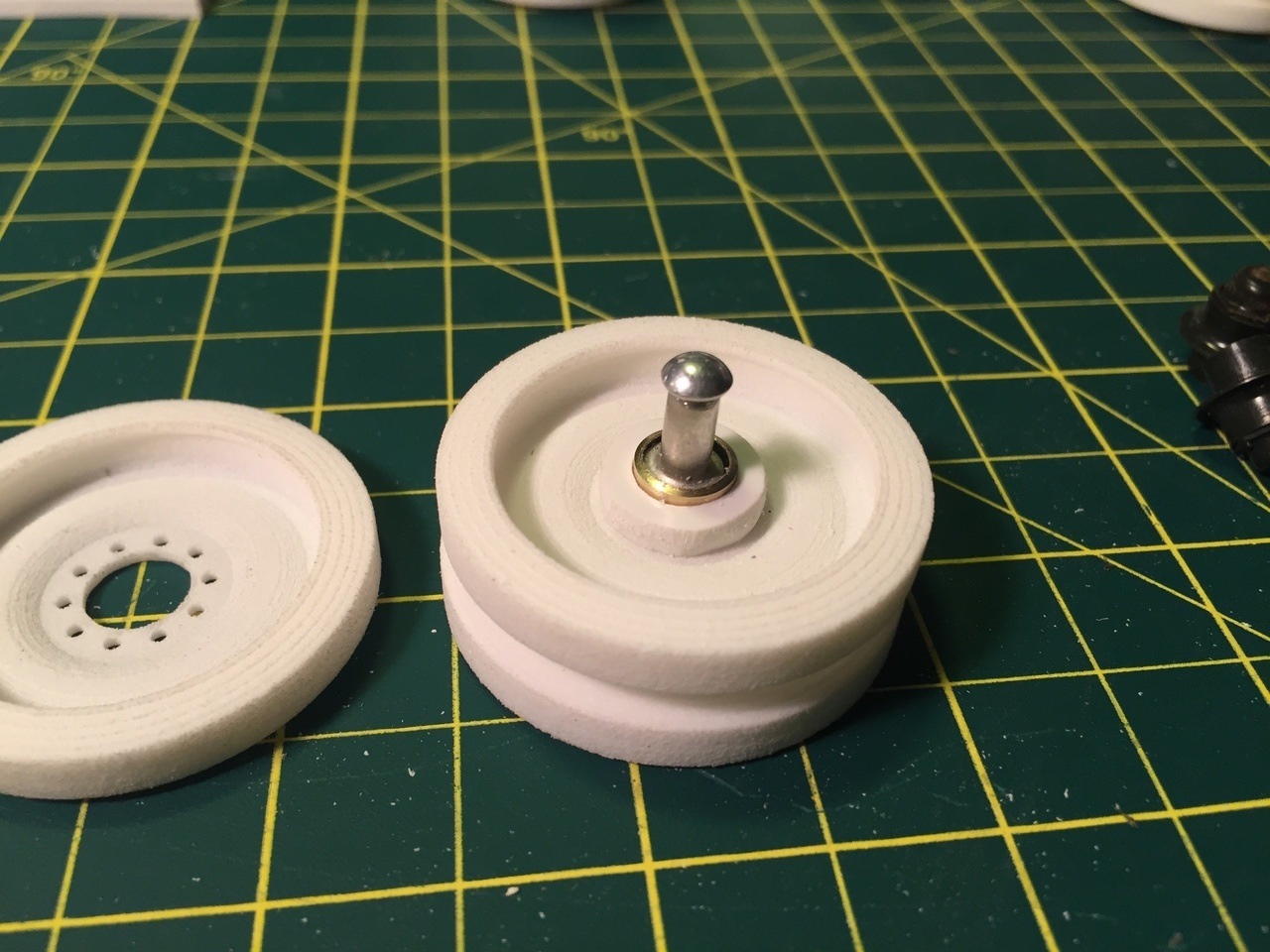

Here are the M113 road wheels. This is one of the few 1/16 M-113 part available on Shapeways.com. They sell for $6 each and you need 20 of them... so it is a significant expense. These are just bare wheels. But there is no real alternatives other that maybe using M41 or Pershing road wheels and modify them. Some experts would design and build these themselves, but I am not there yet. The Shapeways wheels have a good resemblance with the real thing. One obvious mistake are the 10 holes for the bolts, there should be only 8. Not a big deal but it could have been avoided.

An 8mm brass tube provides the central shaft and the Centurion hub cap was modified to fit into it.

A round plasticard spacer is put between the 2 wheels to have the right spacing between them.

The 10 bolts will be made fully functional. Shown here with M1x6 brass hex bolts for display purposes, I have determined that I will need to order 100 M1.2 x 8mm bolts with nuts from Knupfer. I will drill through the spacer and install the bolts with the end with the nut on the front face like the real thing. That should be fun to build and look good..

The bolts will be inserted all the way through the plasticard ring that I added on the other side to create some substance to the road wheels arrangement, the bolts will hold the 2 wheels together, with glue as well to ensure solidity. A 3x20mm metal pin and a socket (again from Knupfer) will be used as the axle. The 3mm axle tip fits tightly inside the Centurion hub. The axle will rotate in the socket that will be made to fit the suspension arm. Oh well.. that's the plan. It is really when the suspension from Ludwigs will show up that I will finalize the arrangement and test it all. They are other arrangements possible as well.

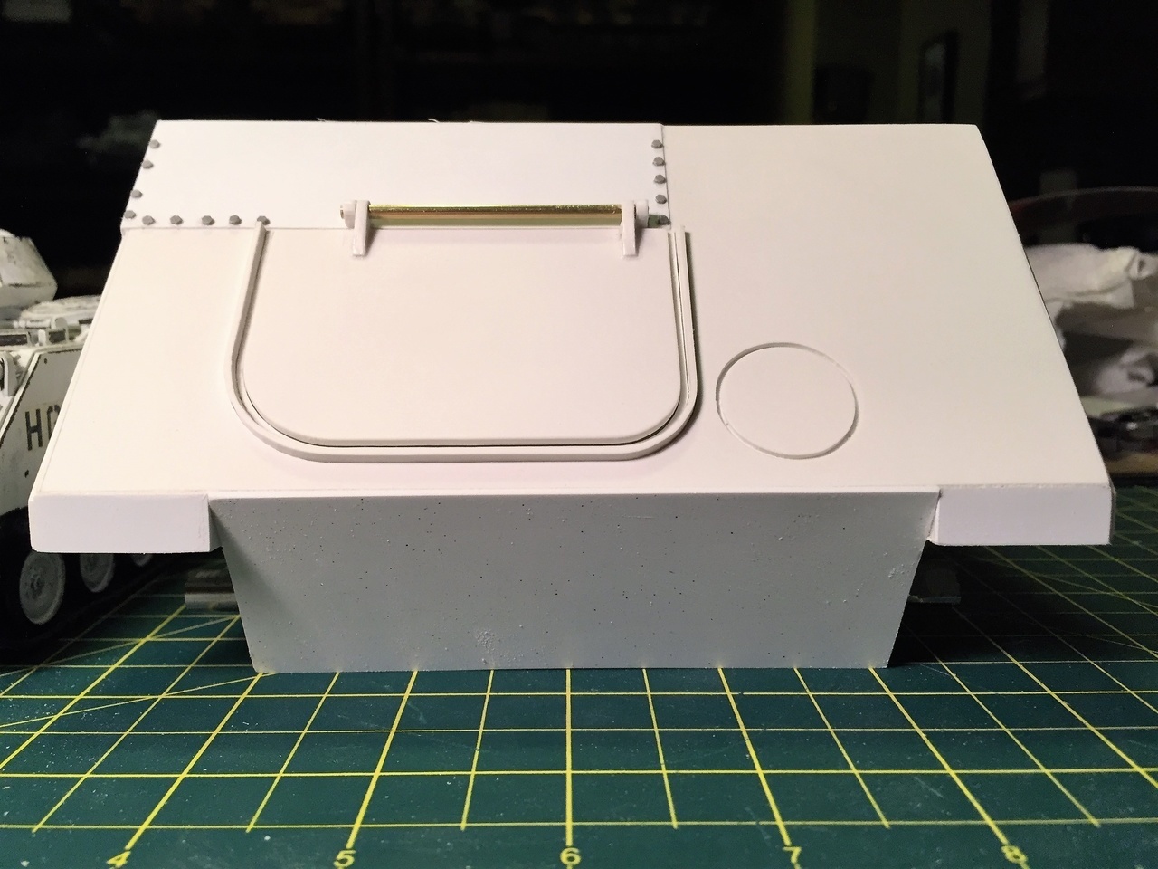

The provided hinges for the engine hatch were modified and redone for accuracy . A KS 2.38mm brass tube was also used. I recommend not to follow instructions but to study references instead and try to reuse available parts when possible. I built the new hinges in 30 minutes.

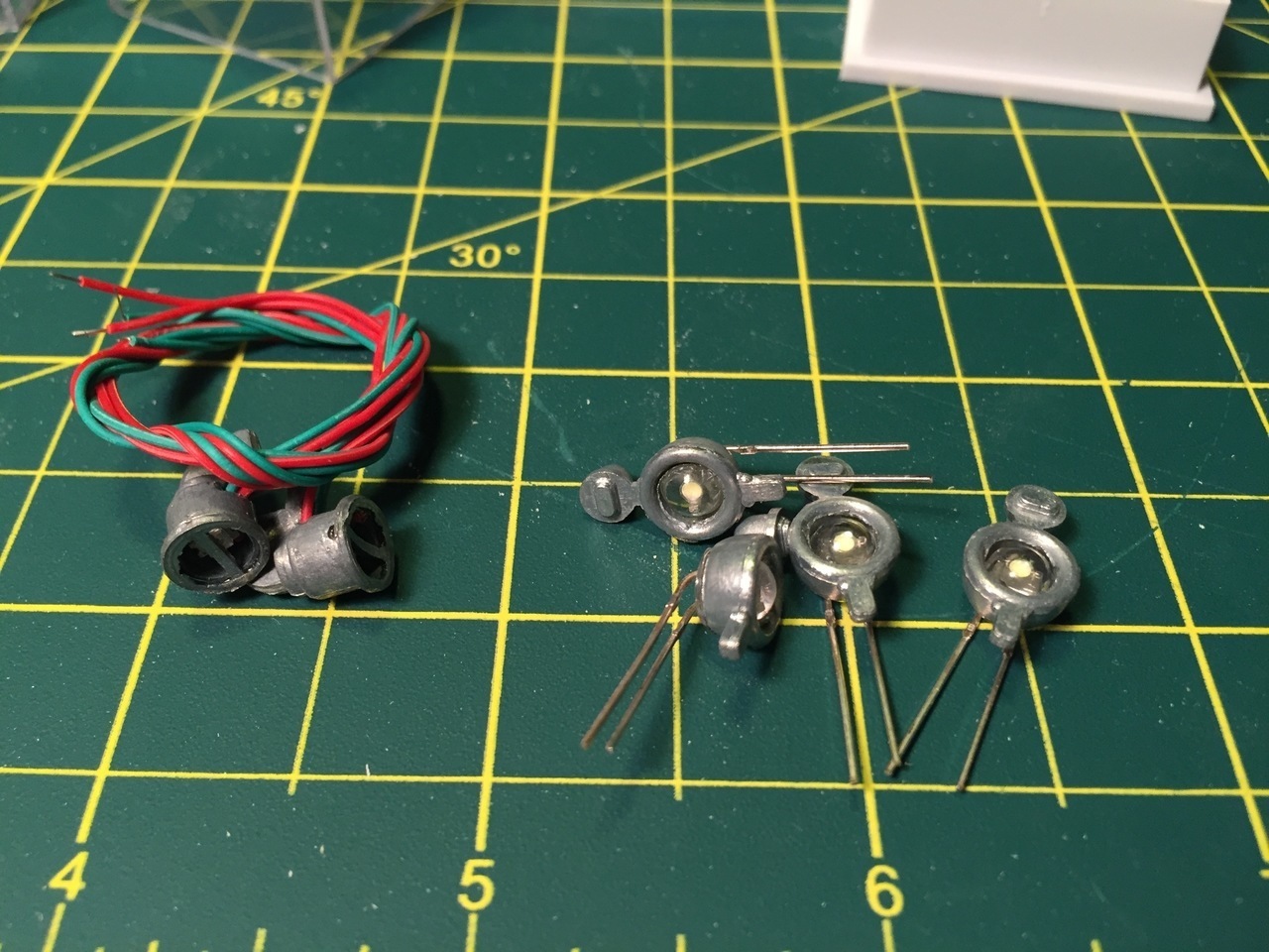

For the headlights, the builder is left to design everything himself. Creating these from scratch is not an easy task because we have to select the material and also determine the location and the size of the arrangement. Positioned on the front like this, they are quite visible and the M113 has a very specific and complicated style that need to be custom made.
References are reduced to a few useful close up pictures. Be careful with Squadron Signal M113 walk around book because many of the close up pictures provided are of the 3rd prototype, the guards shown on these are not the production variant.
Four Mato Sherman lights were modified and installed using my best judgement at calculating locations from 1/35 kit.

The guards are made with K&S 8240, 0.81mm X 6.35mm brass strip. These were formed using pliers and then filed with a hand file to give them the shape you see. A couple of Meng nuts were added as per reference.

These lights are functional and the wires were inserted into the hull where they will later be connected to the Heng Long lights wire.

It was a complex job. Took me about 3 hours of work. P-E parts could have been used to install the headlamps on the chassis instead of plasticard but the P-E parts would have been very small and I did not think it would have looked better with my limited skills at bending these things. Maybe with a cooler head I will decide to redo these, but not tonight.
