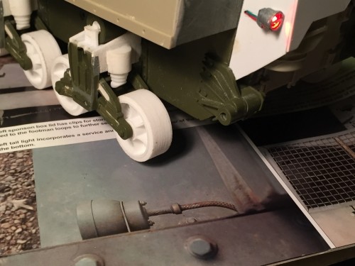

Here is the M7 Priest trialling its new M3 Lee modified Shapeways suspension. These and the spoked road wheels are really nice. Too bad spoked idlers are not available.

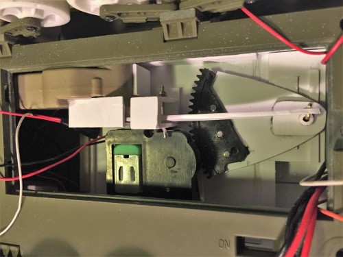

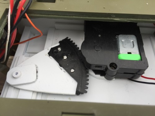

Today was a nice Saturday and I worked outside on the electronics and associated modules. Took some pics tonight.
Here is the gun rotation system. A bit similar to my Nashorn build, it is the Heng Long rotation unit coming with the Sherman that turns a portion of the Sherman turret round gear. It is mounted on a plasticard piece linked to the shaft fixed to the gun mount above. I will put some blocks on both ends so that I do not rip the gun mount by travelling to far right or left. With such (no cost) primitive system, it is only to play around with the howitzer. No one is going to dog fight a Panther with an M7...

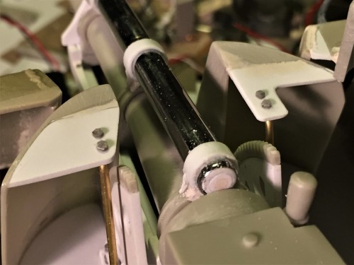

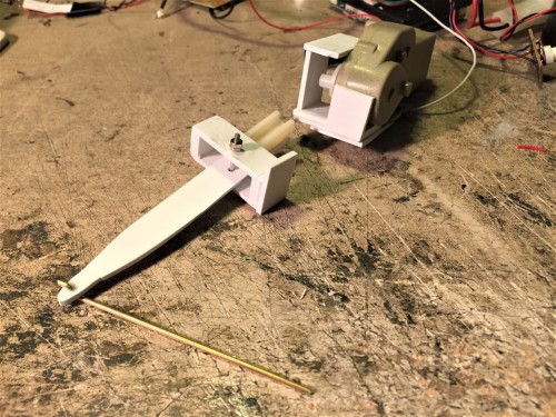

Here a gun elevation system has been built mainly with plasticard and a brass rod, and needs to be integrated with the Heng Long Sherman elevation unit. You must be wondering what is this but see the picture further below
M7 priest electronics

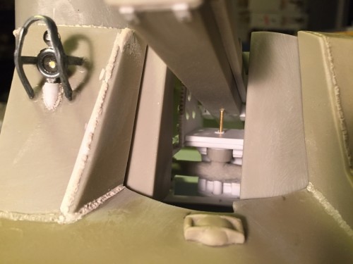

Temporarily in place next to the gun rotation without a single mm to spare, the Heng Long unit is tied to the arm ahead of it. Turning the elevation gear makes the push rod go up and down through the rotation shaft. I have not done extensive trials yet because the gun and the electronics are not yet ready to be fixed in place.

The M2 105mm gun is muzzle heavy but light, and the natural position is down. The push rod from below pushes on the cradle to make the gun go up and down. This view will be hidden by a central gun shield section that has not be built yet. Notice the Mato lights and metal frame.

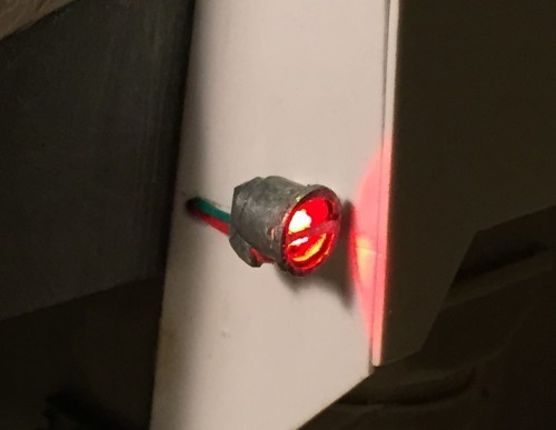

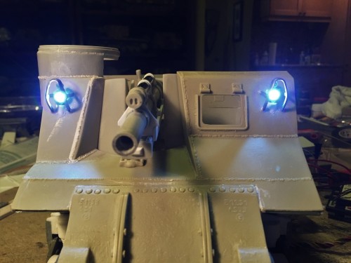

I initially wanted to reuse the Heng Long lighting units but once cut and taken out of the Sherman upper hull, they became very fragile and the wires were not long enough with the new setup. So, I ordered brand new Mato metal Sherman lights from Forgebear. It is a rare luxury with this build. They were easy to install but the metal is difficult to alter, the metal will break instead of bending. You have to be careful not to ruin them when doing alterations to make them fit the M7 hull.

Same treatment at the rear with Mato rear lamps. Again, the Mato metal is difficult to work with, there is not much that can be done to remove excess material without damaging the wire and lights.

I would have normally put the wiring strait inside the hull sides but references show the wires going externally forward before entering the hull. If I had to redo it, I would have put the Mato wires strait inside and put a single fake wire going to the front to simulate it. Too late now, I won't redo it.
