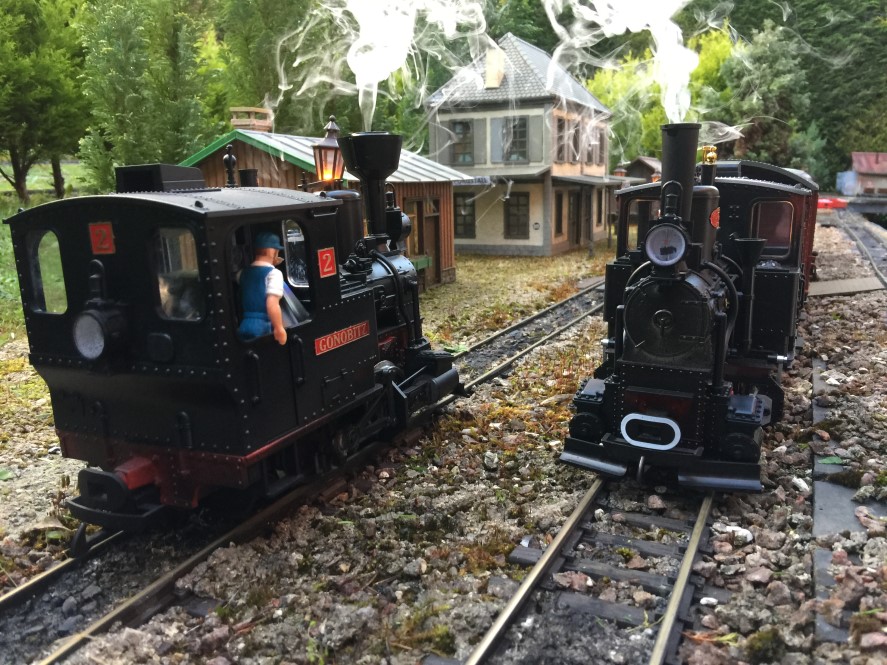

My locos smoke using a 50/50 mix of citronella/barbeque lighter fluid :
They will also work with baby oil and the oil the manufacturer (Lehmann Gross Bahn) supplies.
