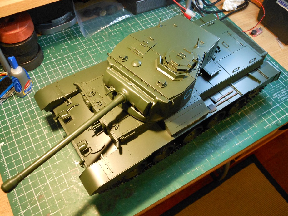

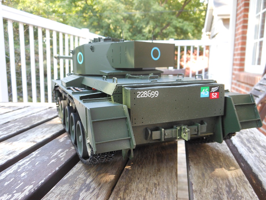

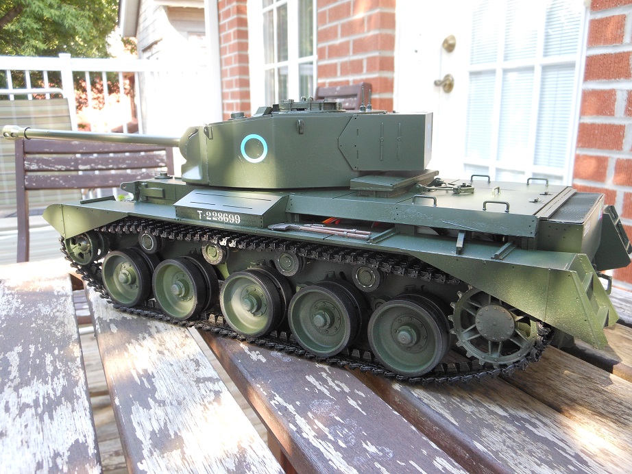

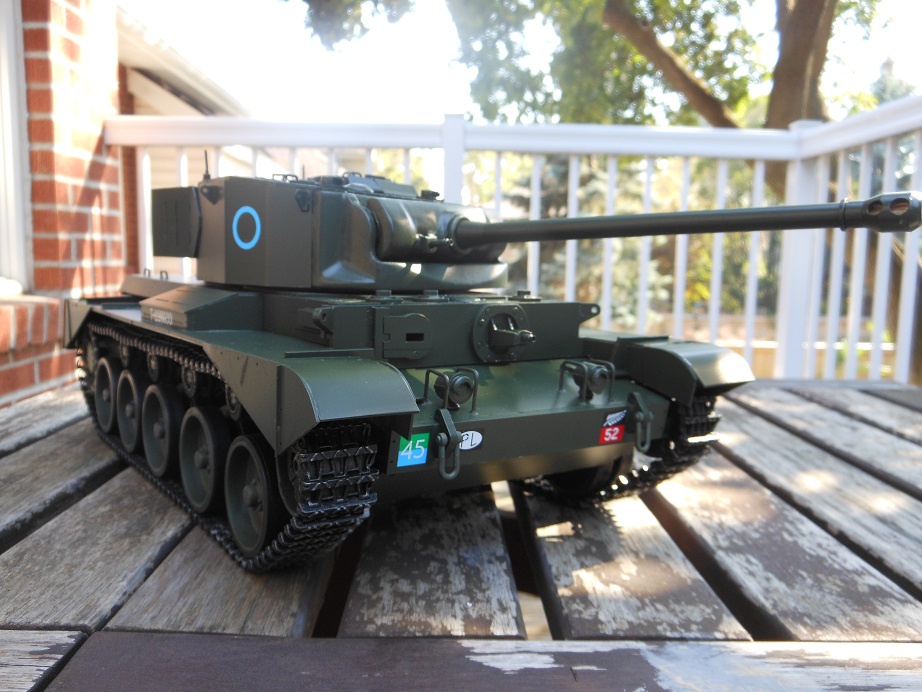

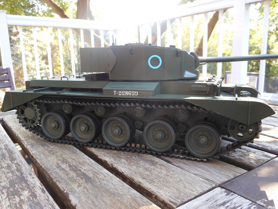

Thanks everyone. I quite like it myself and it turn out better than I expected being the first kit from Chirstian Ludwig. Second kit is on order.......
ALPHA, here you go...... Are you looking for something specific ? Let me know and I will take pictures for you. Not everything is from the kit and I have to improvise.
Max, I had the early Pz III plastic sprockets and plastic tracks on battle day and it didn't last. The tank was just too light, no grip at all on the short grass, and the plastic track came off the sprockets in the first battle and I didn't use it again. The metal late Pz IV sprockets seems to have more contact on the metal tracks, and both being metal there is some weight to it. I run my Clark board with steering and throttle on the right stick, turret rotation and elevation on the left stick, fire/MG/Lights and engine on/off are located on the switches (Using Turnigy 9XR with ER9x Anzio firmware from RCTA).
