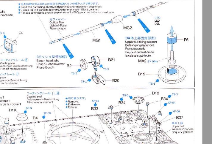

...and, of course, your Tamiya static Tiger 1 to roaring RC Tiger has been one of the most engaging threads in recent times, Painless. :thumbup: However, for conversational purposes
here's a clip from my King Tiger build manual:
Bits needing the mystery bonding agent...
The joints on the MG are shown needing treatment with the blue tube sporting a capital "G". In the introduction to materials and tools needed, Tamiya state (re: the "G" tube) : "Apply synthetic rubber cement in places shown by this mark"..
On various forums, equally in- the- dark- builders have noted that rubber cement would be more flexible than CA or Epoxy, and also permit easier future separation of parts, if needed. Sounds about right; but it would be handy if Tamiya had stated that.
