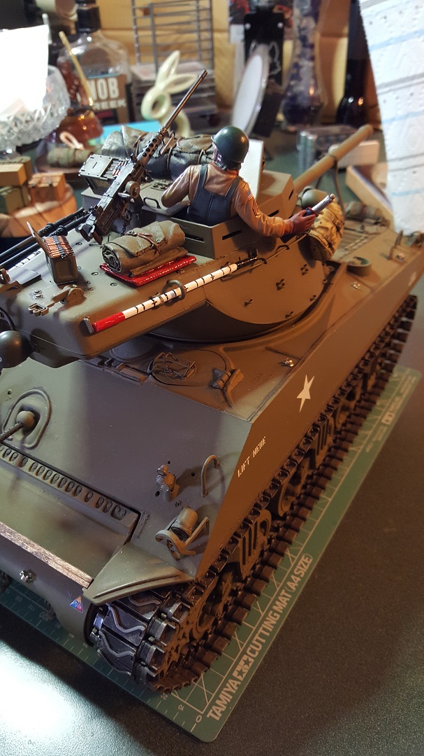

Got tired of waiting and went ahead and mounted the Schumo tow cable kit using 'Maxene' as a guide for location. Both vehicles are based on M4A3 lowers and uppers so spacing worked out. Mounted the crew helmets and the front fender tarp using 3M tape so they are not going anywhere. Lastly, I put together an upgrade for the crate of chocolate using an idea from the General. Pics:
Crews helmets mounted
Rear cable mount...Both mounts are functional and the cable can be removed and used
Tow cable mounted!
Tow cable mounted!
All of the Schumo cable mounts drilled and installed.
The MATO metal is tough to drill even using carbide bits in a Dremel tool.
Rear cable mount placement on 'Maxene'
Getting tow cable mount placement ideas from 'Maxene'
Excellent Schumo kit for the M4A3 upper which the M36B1 shares!
Trip wired with a couple of German Potato Mashers...Nobody is scavenging Joes chocolates!
WIP on an idea from the General

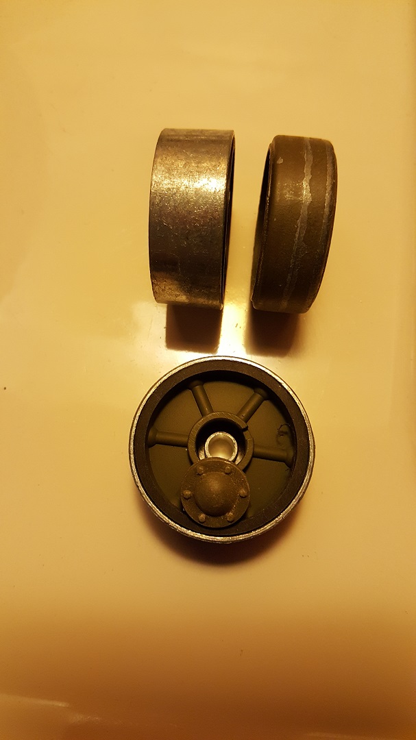

'Maxene' has always been a favorite of mine. ;o) I spent my lunch today altering a pair of metal MATO Idler wheels to replace the metal HL version ones. Since 'Maxene' was my first Sherman and built during the period when the HL Sherman was new on the market, if you wanted nice metal tracks\sprockets, you went with the MATO pieces. The tracks were not hollow blocked\incorrect as the HL tracks were at that time but you had to alter the MATO sprocket to fit the HL shaft. Fortunately, the altered MATO sprocket came on the market during the build so problem solved there. However, the HL idler is narrower than the MATO track run so to get tracks to ride tight and straight, you had to use the MATO idler with it's funky 12 spoke cover. For years, I have made do with the HL idler wheel until a very good Friend made up a set of standard 6 spoke covers that could be dropped into the back half of the MATO idler wheel. I've drilled out the MATO wheels to take the HL screw mounts so after this, 'Maxene' will run just that little bit better. Less strain on the steel gears, idler mounts and track runs.
Modified idler wheel mounted combining the HL wheels correct appearance with the correct width of the MATO wheel on the tracks
Width difference between the HL and MATO idler wheel is easily seen alongside one of the modified MATO idler wheels
