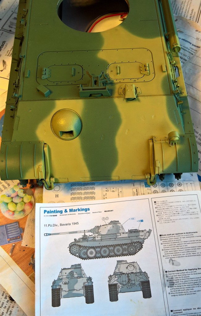

I just started the camo. Unfortunately the dark yellow didnt want to paint smooth enough fo rmy taste. Maybe I added a bit too much thinner. It was like spraying wet sand, on the other hand I could get the lines neet enough and them gradually filled in the areas. Did the front hull angled plates, left side front and top. I guess it will look great when the fading process begins
Interesting how Long this took. Including a nice cleaning of the airbrush I was busy Close to an hour.

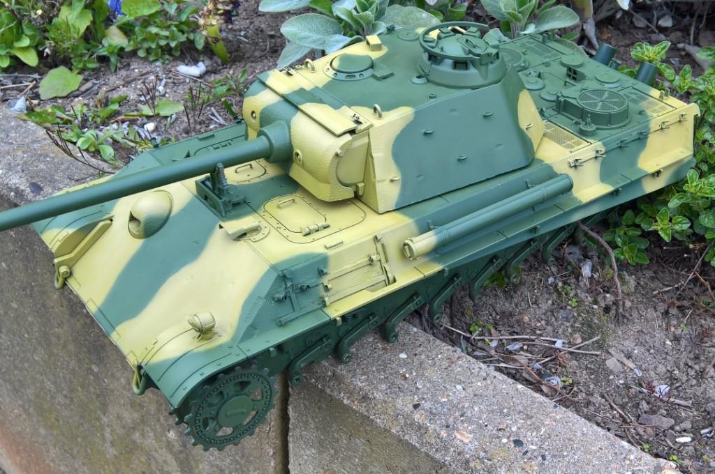

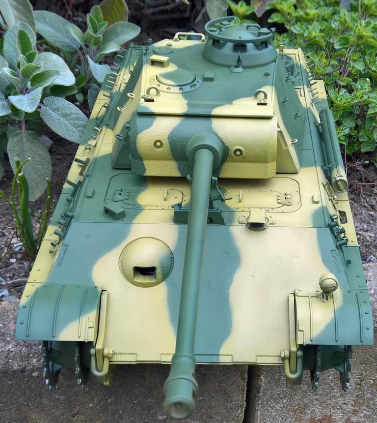

Panther is coming along. Had some Problems wiht clumping of Pigments in the yellow paint. So redid the edges with green and got some overspray. That is no Problem though, as I still Need to Highlight the yello aread before filter, pinwash, oilmodulation, grime, streaking, pigmenting....
The turret i started with vallejos masking fluid right away, it kills the brush, but it is really easy to rub off. even from crevices and small Details, by a mere stiff brush.

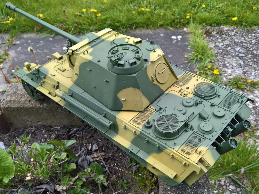

Base Camo done... Now Stencils and well,... forgot the Barrel... Some touchups are needed. Those will be done during weathering.

Re: Jagdpanther G2 base on Heng Long Hull
Absolutely stunning work Sir
this camoflouge pattern is exceptionally done. I will continue to follow along and can't wait to see it finished

Thanks, I am looking Forward to this as well..

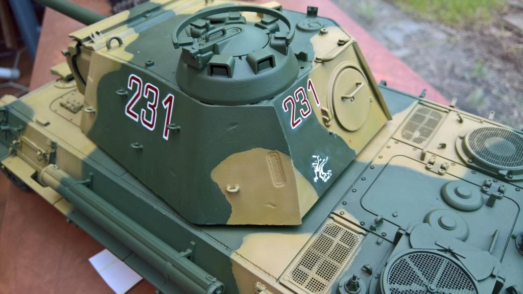

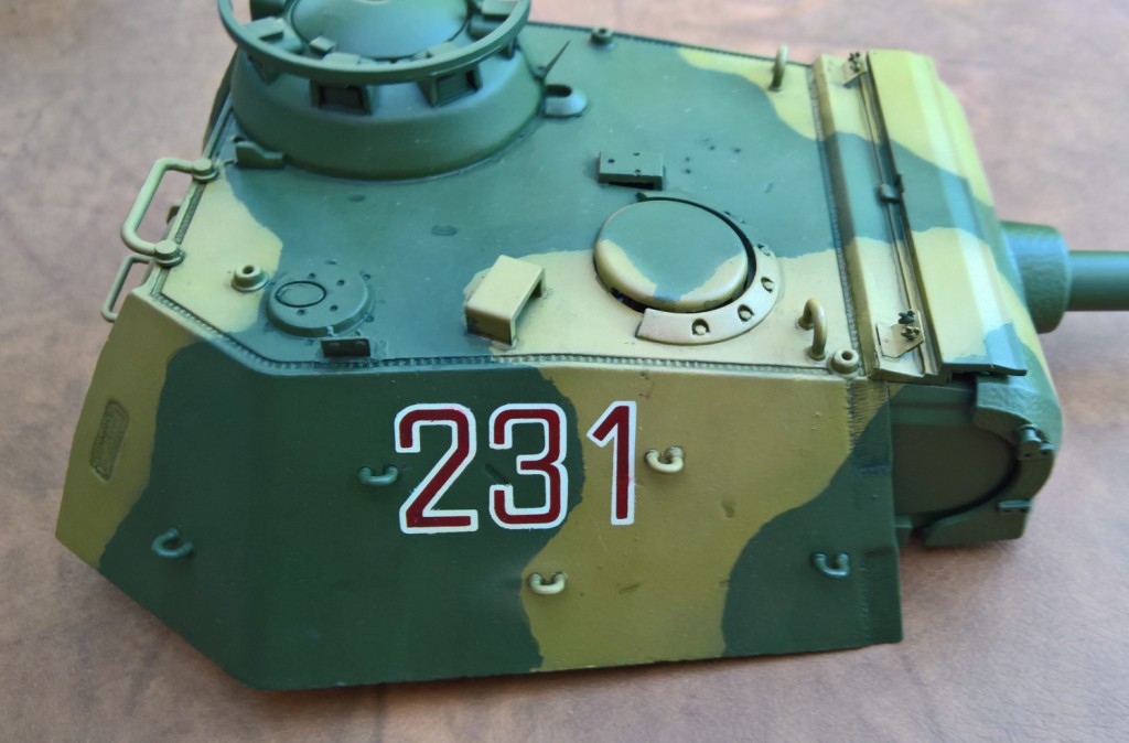

Just applied the markings wiht RCtanks stencils. Those went on nicely, although the odd drop of paint going elswhere ist always possible. So clean up is required here and there. The red is a mixture of Revell Ferrari red, Vallejo hull red and a bit of flat varnish. I like that.
Well and most, if not all "unclean" spraying will be covered by filter, streaking, Pigments, what have you.

Yeterday evening I added acoat of MIG Tan Filter for tri tone camo. It is golden Brown and enriches the colour a bit more. Thinned it down 50:50 in AK odourless thinner. This morning I gave it a gloss coat and started with the pin wash. A mixture of 85% Vallejo Olive wash, with the remainder of equal parts light Grey and Brown wash. This gives the bas colour of the tank shining through the dark yellow, but Overall being greyish grimy.
