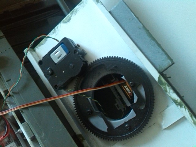

This is how I positioned a rotation motor in my scratch build Comet, which has the same upper hull design.
- IMG_20170410_124442.jpg (89.77 KiB) Viewed 1316 times

Just keep in mind most rotation units use the 180 motor through a reduction gearbox so there's very little load on a relatively robust motor.
If you take a servo and mod it for continuous rotation, it will work, but you're asking a smaller motor to do a job it wasn't designed for. Servo motors are chosen to do short swift bursts.
The gear head motors are a better choice since the load will be minimal, just choose a ratio and center the final rotation drive gear on it. It'll take some work to mount it, etc.
Adapting the hL parts will ultimately be the easier route if at all possible.
