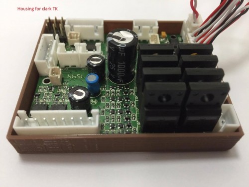

Max, that TK60 sound set sounds great! :thumbup: Is that the same set as is on the TK24 (I saw on DKLM site they offer a TK24 for T-90) or is it a set you did yourself? If the latter can you put this sound set on a TK24?

I can arrange a tk24 t90 for you , no problem. I have on order now for shipping on monday a quantity of ( pre sold ) tk22 ,24 and tk60 to me . If you allready now are set on one, I can include it, ore if you need to think about it , it's probably not long until I make New order. :)
I can promisse a fair price , Board included With 3d printed casing , a small Norwegian sweet, and low shipping cost .

Thanks Max. Having only just got the T-90 I'm still in the 'planning' stages so, as you suggest, still thinking about what way I want to go. But when I start work on this build (and if I decide not to keep the HL MFU) the chances are high that I will go the TK24 route now I know you can supply with that T-90 sound set - when I do I'll order from you for sure.
