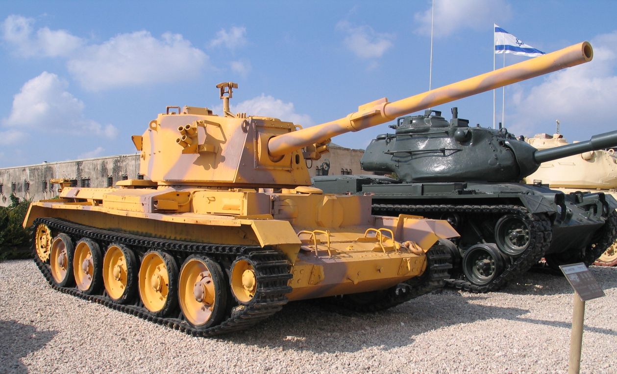

In the meantime, I found pictures of these very unusual Cromwells:
They finally put a massive gun on the Cromwell
That was a leftover post-war adaptation.
Then, in the A30 guise of the 'Challenger', whilst sporting the 17 pounder mounted in an absurd turret:
Big head on a little body..the 17 pounder adaptation
Challenger Cromwell A30.jpg (38.54 KiB) Viewed 7605 times

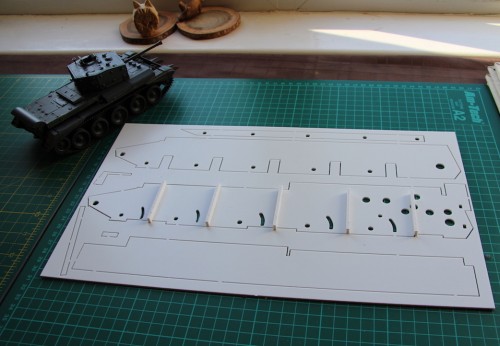

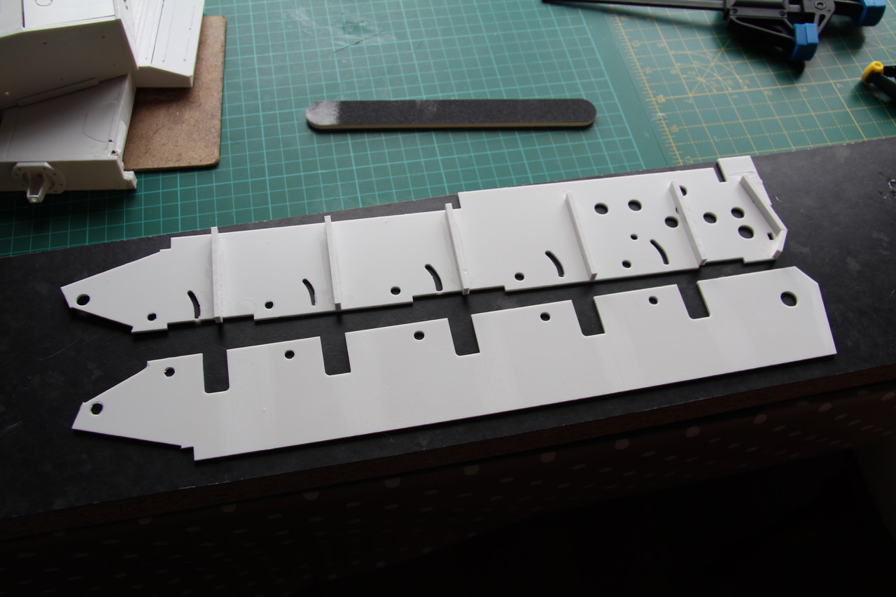

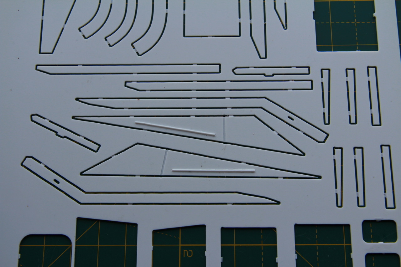

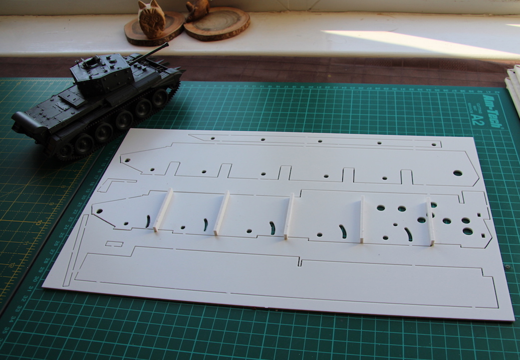

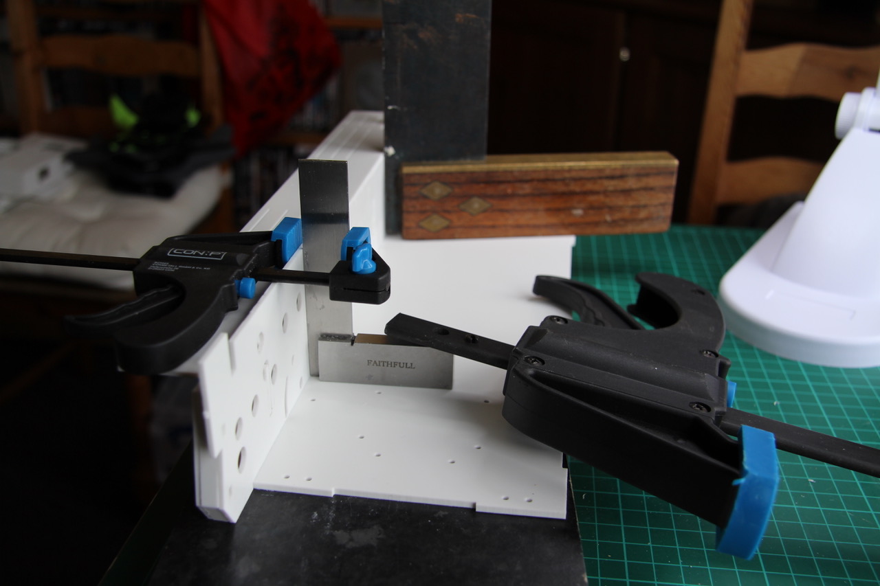

Still waiting for a few essential parts. I've also been giving my lungs and brain a break from toxic fumes (even though I use a mask and have breezes blasting though.. :| ). In the meantime, I've made a start on the lower
Hull/ Chassis. Christian's instruction Pdf. shows the suspension arms being fitted before the track plate/ mudguard assembly is fitted to the hull floor. As it's crucial to get that joint absolutely plumb at a right angle, I decided that to have spring loaded arms in the arrangement process wouldn't be the best method of doing that... :shh: Looking at the way the arms are configured, there should be no problem installing them after the main components have been bonded in place.
Stage 2: The Lower Hull:
The plastic meat in the sandwich..
Track plate ready for mating...

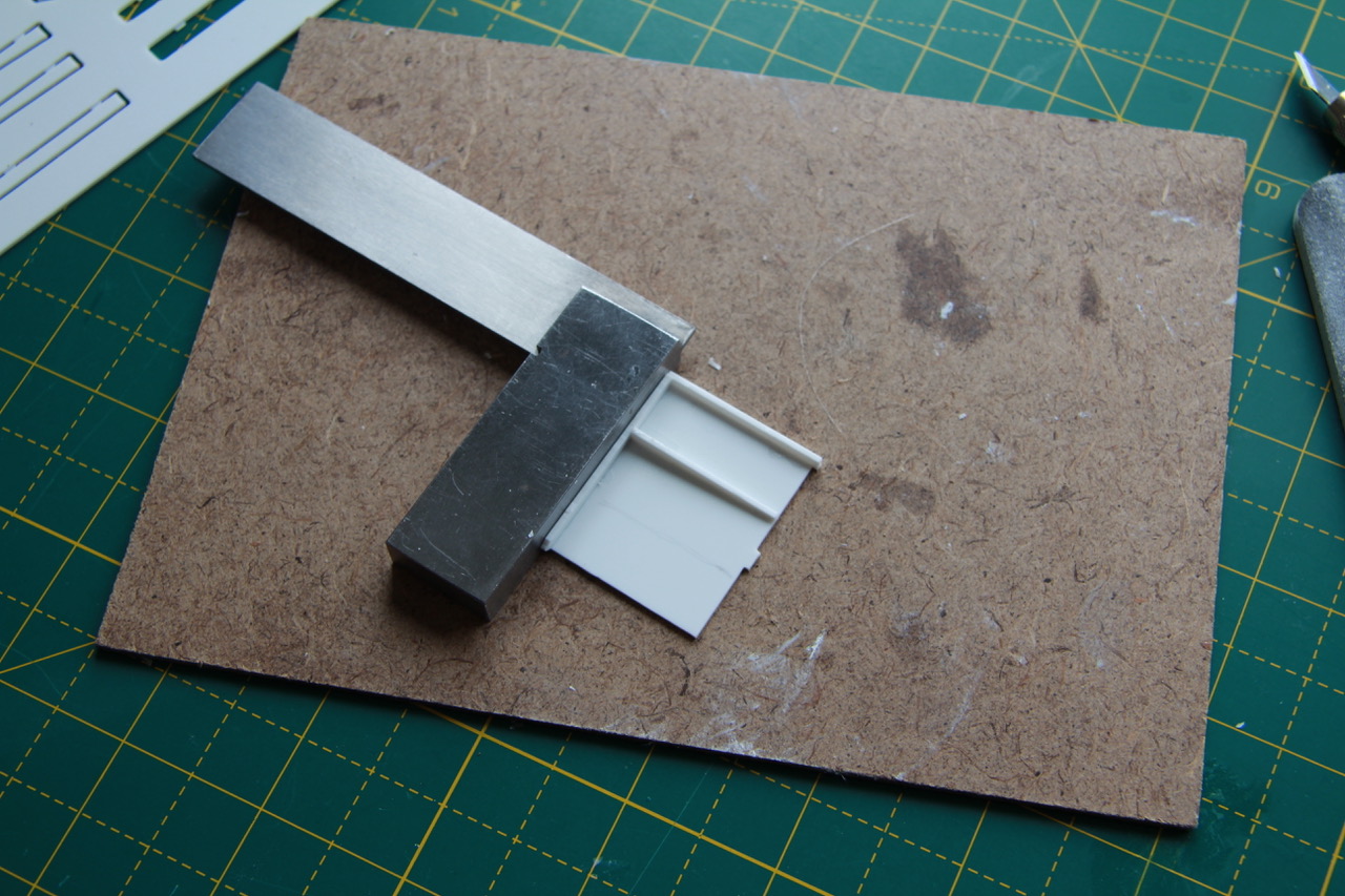

Right angle- right way to bond Track plate..

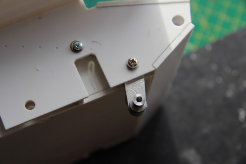

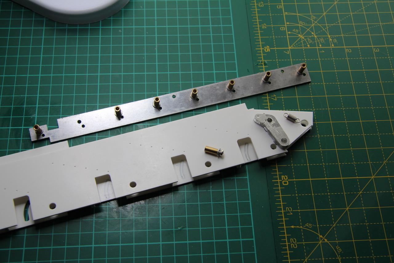

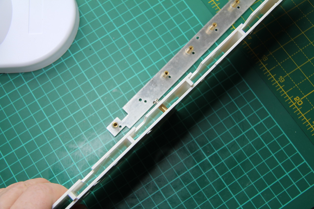

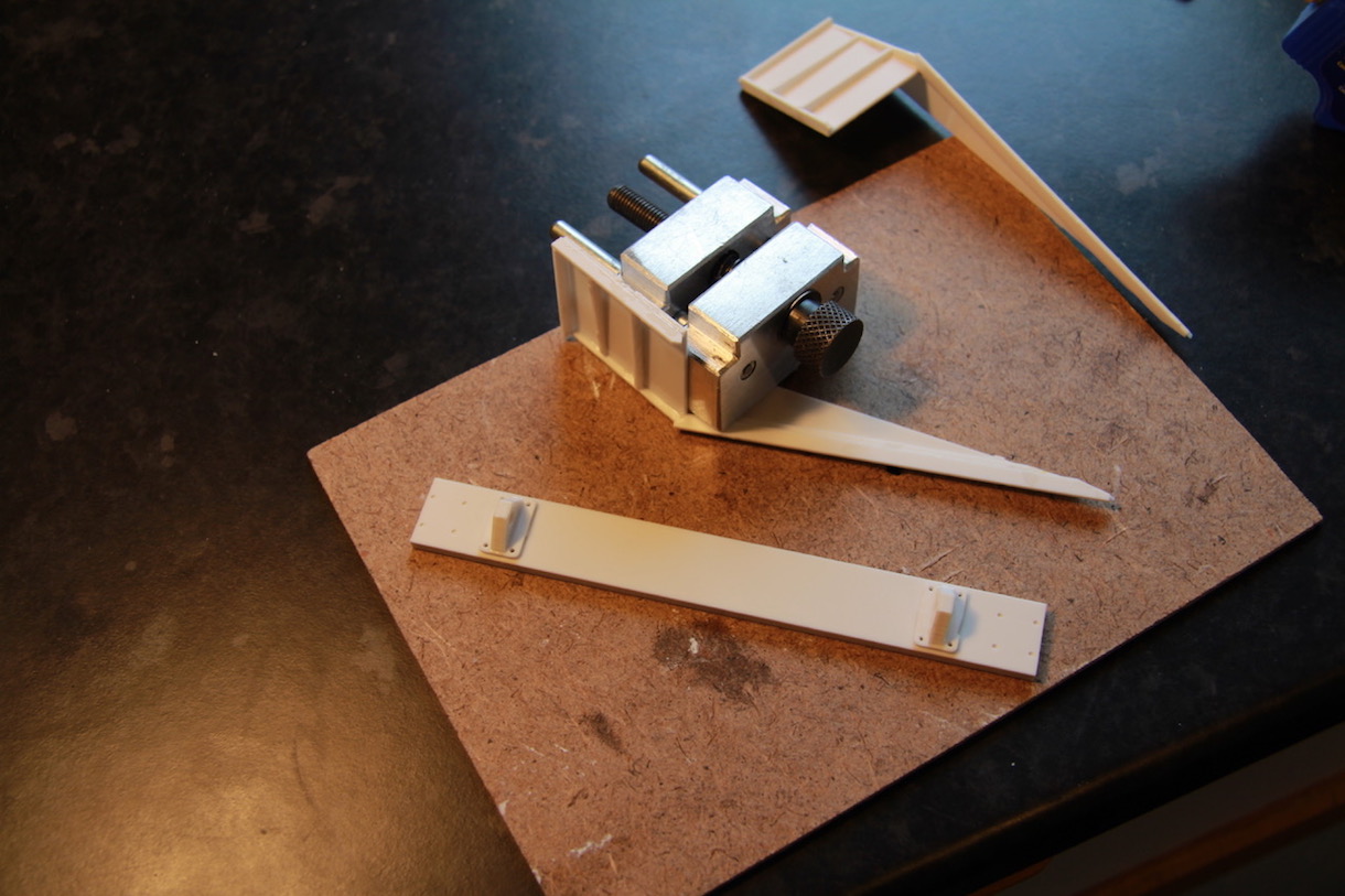

An old HL tiger 1 suspension support is donating brass pivots to the Cromwell :thumbup:
Donor Tiger 1 pivot assembly
It will look this this..
Preview of brass suspension arm pivot...

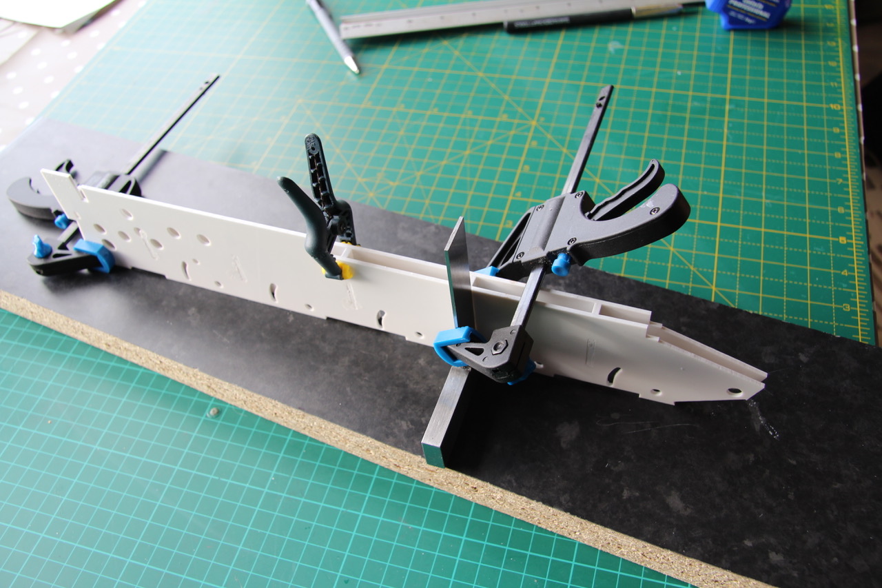

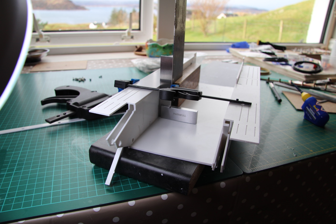

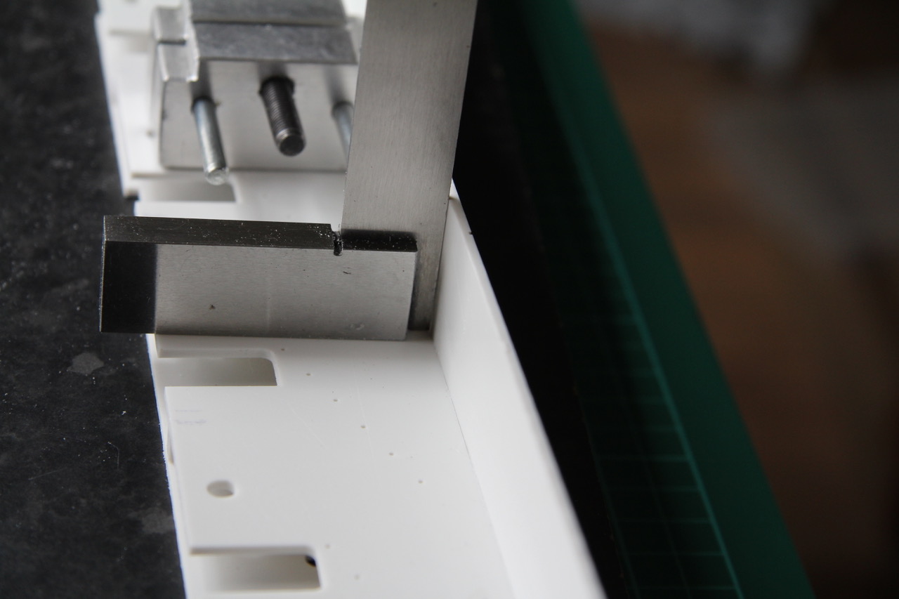

Now, the Track plate has to be bonded at an exact right angle to the Mudguard.. :think:
Trusty Faithfull set square to the rescue

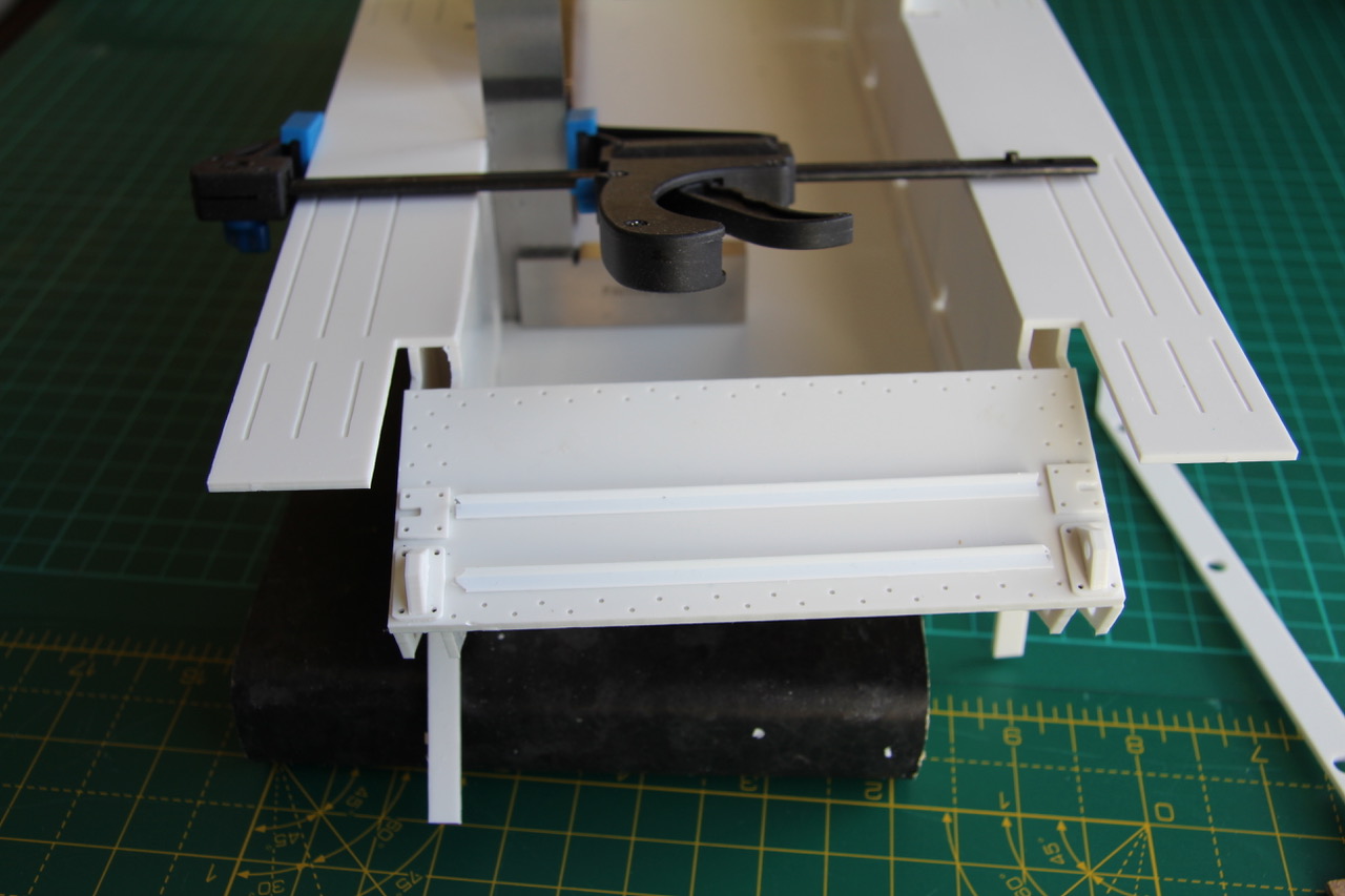

If I had nails to bite, I'd be chewing them. Now comes another crucial step: bonding the track plate to the Hull floor. The Join must be tight and at right angles. Sometimes wish I'd been born with three arms :lolno:
Bonding Track plate assembly to Hull floor
and the other side:
Nice day for it..and plenty of natural light

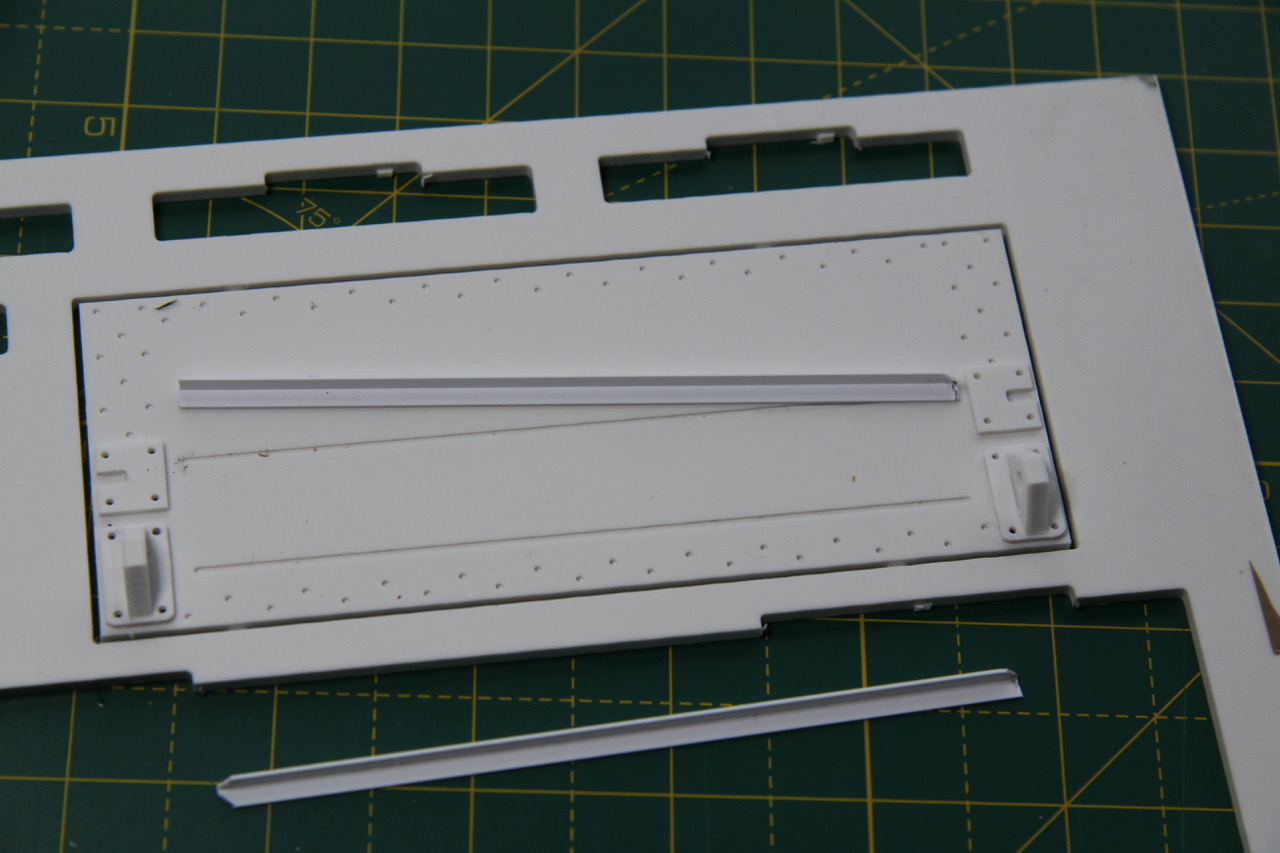

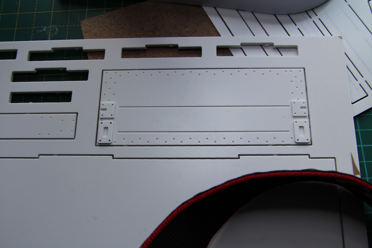

Now, it's time to assemble the Glacis. To line the wee shackle and mudguard bases up with their intended 'bolt holes', I drew dots with a marker pen on the 'holes'..so they'd be visible the plates. That made alignment simple.
Glacis plate
Glacis plate
Now ready for fitting to the Track Plate and floor assembly..
Glacis shackles and angle iron..

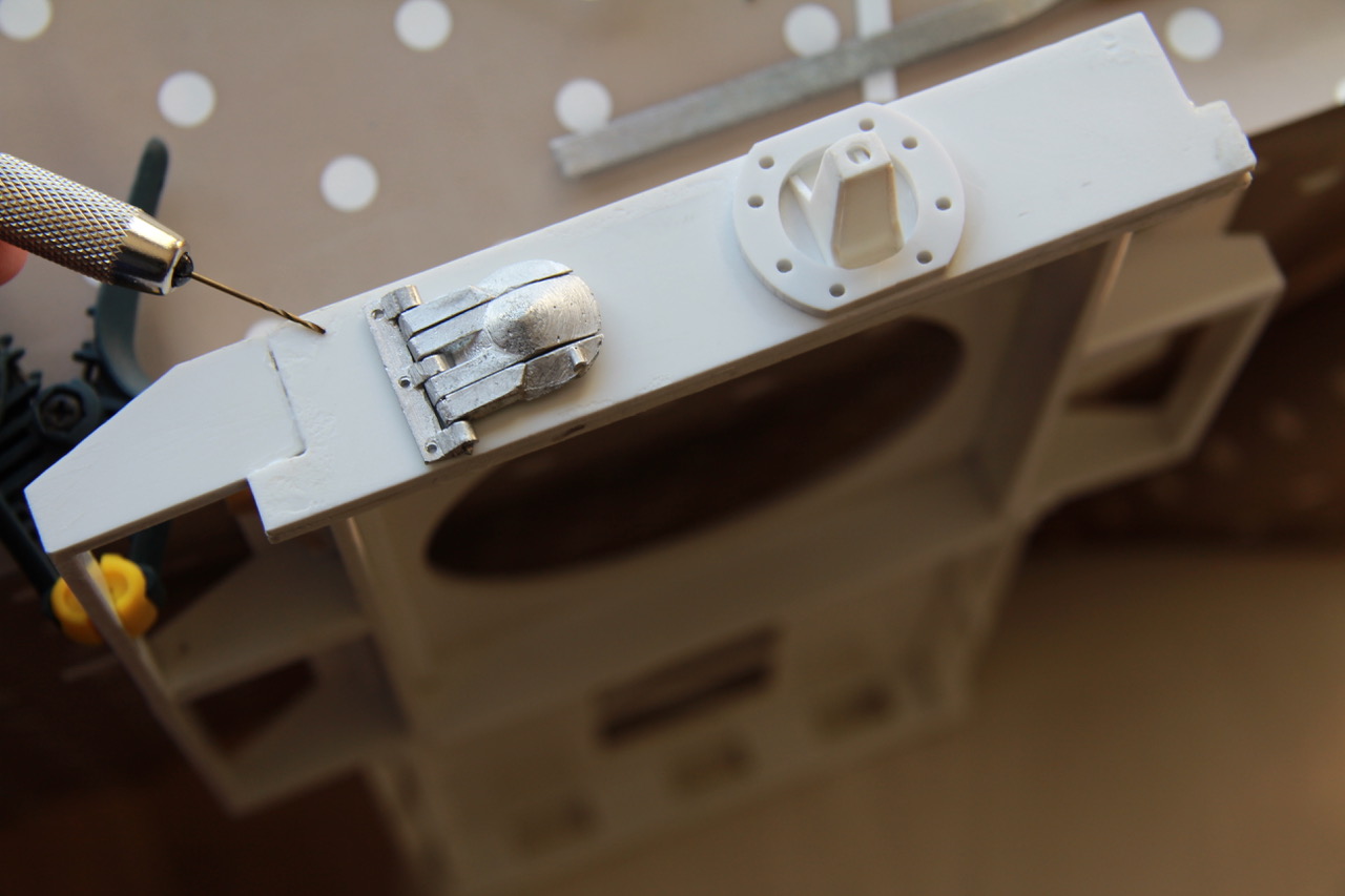

Build continues slowly, as I've discovered tools I need that I don't have, and had to order. The same goes for miniature screws, hinges etc.,as well as bits from our Teutonic tech maestro (Chris..)

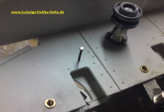

Ludwig designed Cromwell Driver's hatch

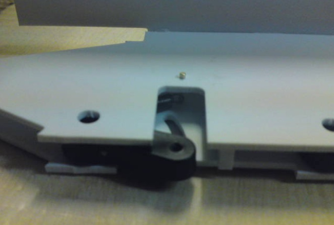

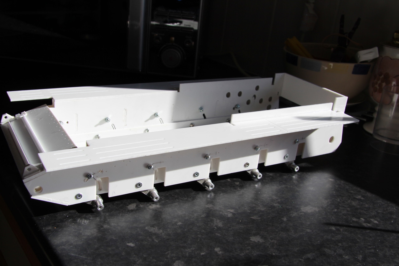

Now back to the suspension. I opted for metal suspension arms with springs. The original ones used on the Comet and Cromwell employed by Christian were plastic Tiger 1 types fitted thus:
Tiger 1 arm fitted to Cromwell
Suspension Arm from Tiger A.jpeg (47.26 KiB) Viewed 7476 times
Note the Brass pin directly above the assembly, in a central location. That serves as the Suspension ring retainer. Later versions of the Comet and Cromwell have revised metal arms fitted, but note that the wee Brass pin is still in the same location :think:
Suspension with metal arms and spring
Suspension Arms -metal- B.jpeg (48.97 KiB) Viewed 7476 times
Now, its little else to go one, I put the suspension spring retaining pin/bolt in the same central location, (marked in pencil) thus:
When fitted, it became clear that the spring was stretched almost as far as it would go. In fact, the suspension was so taut that it could have been for a Tonka toy (if anyone can remember those taking the weight of a car in Tv adverts.. :O )...
The Rite of Spring..
Suspension Arm B.jpeg (92.63 KiB) Viewed 7476 times
and looking, and feeling (rigid) more like aircraft landing gear:
Wee pencil crescent is where I think the Pin should be..
It now occurs to me that one of the hardest aspects of scratch building a model tank, is getting the suspension right. First you have to decide on how strong it should be (i.e what springs to fit, or dampers), and also where the ride height (seen through the centre of the wheel axles) should be settled. :think: Another time, I might even use the adjustable suspension/telescopic damper units used on model cars.
Anyway, I decided to moved the Pin positions to the right (marked with pencils) and reduce the ride height, as well as the unacceptable tension on the springs.
Pin relocated left for left side, and right as appropriate
Talk about learning curve :eh:

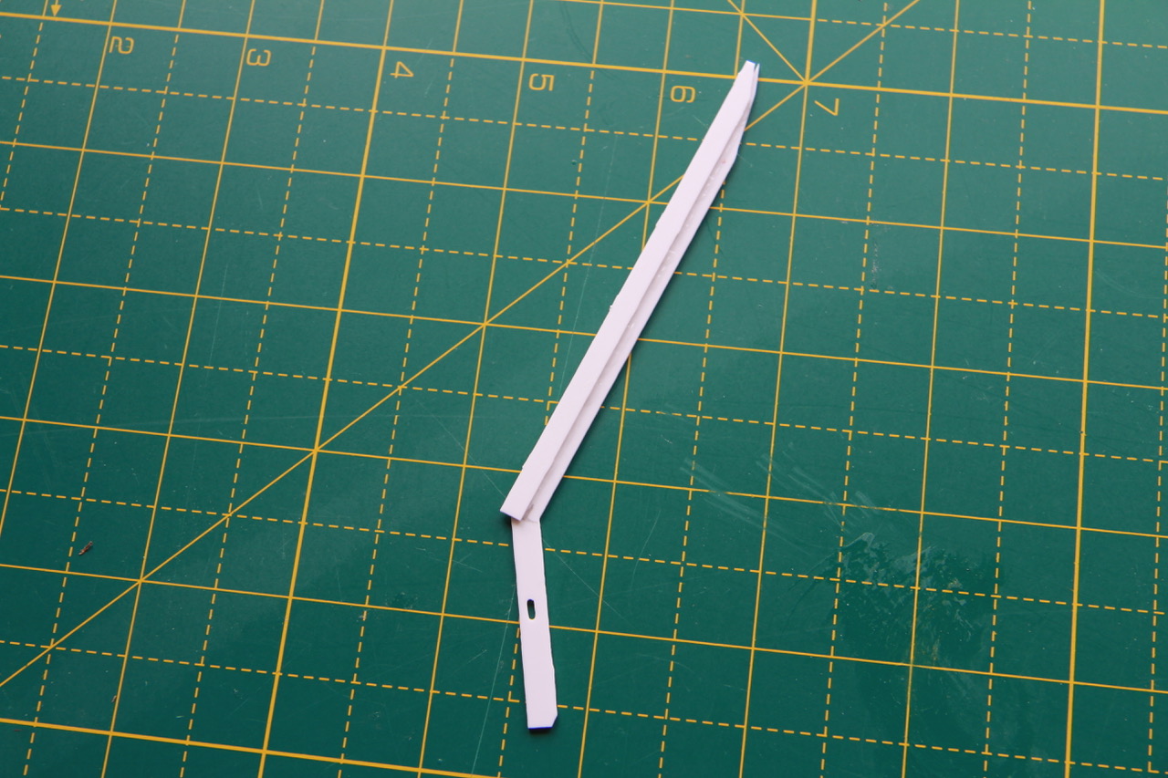

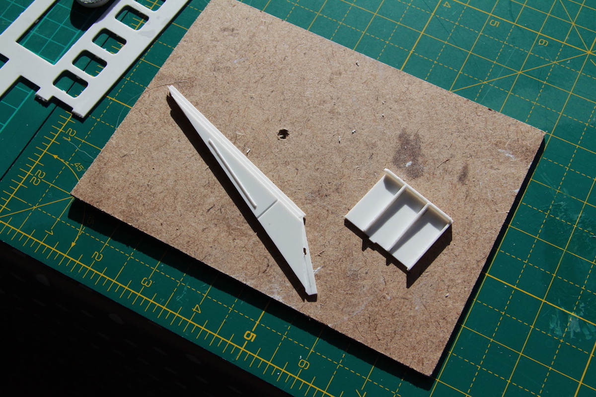

Now for some details. The rear mudguards first.
Distinctive Cromwell shapes
Building layers up
Building layers up
Where there's muck..there's...steel
Taking shape..
Taking shape..
