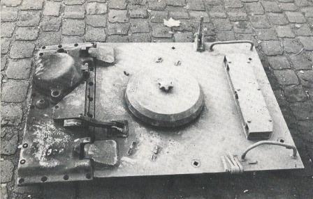

The two pieces the final drive cover goes on the inside in the front, here is a pic of the exhaust armour cover on the real thing:
Tiger 1 rear engine hatch - this one actually removed from a Sturmtiger captured by the British.jpg
Tiger 1 rear engine hatch - this one actually removed from a Sturmtiger captured by the British.jpg (28.31 KiB) Viewed 2365 times
Aussie
Posts: 471
Re: Taigen Armoured Transmission Engine Covers Tiger I
Post by Aussie »
"INTAKE" , armoured cover , only used if not using the feifels.

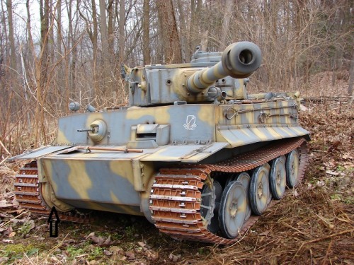

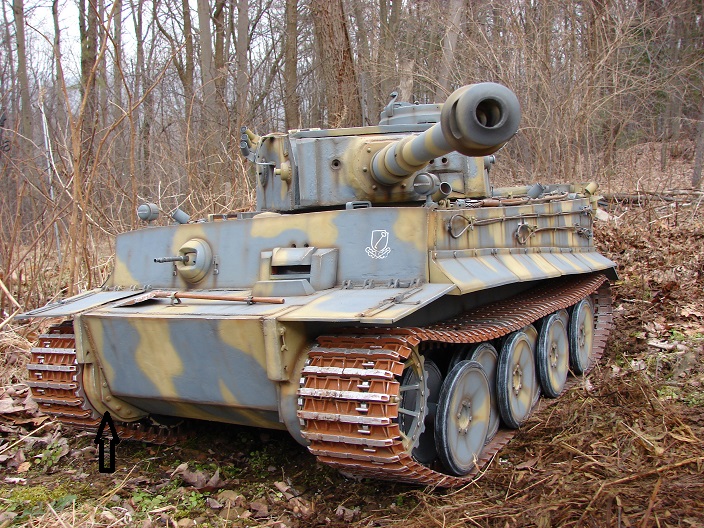

Before you fit the two transmission covers I suggest you do a dry run and just slide them into position because you may find that to get a good fit you need to clip off the end and file a curve into the leading end.
Certainly all the ones I have fitted if you don't adjust them they don't fit behind the towing shackles.
