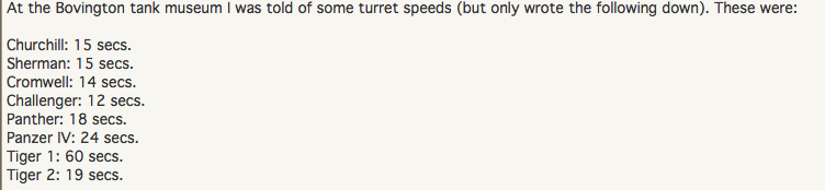

Re: Turret rotation speeds on WW2 tanks
Here is some of the info I have collected.
I will look for more that i have gathered.
Afrikakorps
Afrikakorps
- Screen Shot 2015-01-23.png (36.01 KiB) Viewed 6957 times
