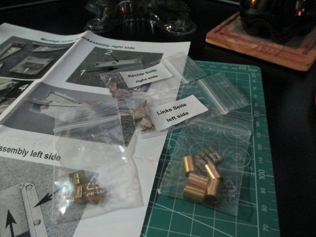

Continuing on with Step 27 ( and it's variants ) Sassgrunt had sent along a set of beautiful Schumo 'S' mine launchers for an early Tiger. I pulled them out and checked all of the parts and proceeded to install. They are solid in a way that only nickle silver and 3D brass is and assembled and mounted beautifully all the way down to the last set which was for the Left rear. There I discovered that Schumo had shipped this set lo' these many years agone with two right side braces instead of a left and right for the two rear mounts. I went ahead and drilled and mounted that last set and will either locate a brace or build one myself out of styrene. Irritating but what can you do? Pics:
- The 'extra' right side brace.
- The 'extra' right side brace..JPG (88.18 KiB) Viewed 3438 times
- Assembled with Epoxy for strength
- Assembled with Epoxy for strength.JPG (94.9 KiB) Viewed 3438 times
- Drilling for the platform to mount
- Drilling for the platform to mount.JPG (85.22 KiB) Viewed 3438 times
- Schumo 'S' mines
- Schumo 'S' mines.JPG (95.04 KiB) Viewed 3438 times
